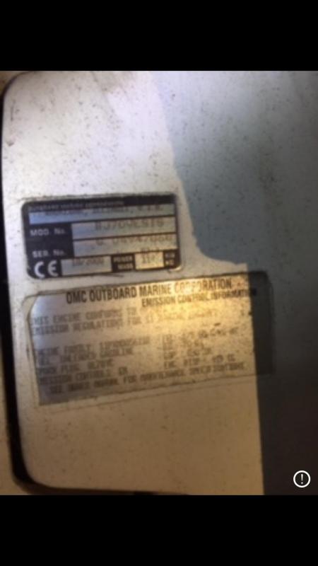

Hi Racerone thanks see below. Located in Melbourne Australia.

Hi Racerone Apologies about the above replies phone would not upload photos. See below thanks for the help!

Do a compression test and perhaps a sea trial before handing over the coins.-----Install a new impeller if you buy it.----Looks like a standard gearcase to me.
Thanks. Already have came out at 100, 98,100 PSI how is this? FYI the engine hasn't run in around three years would this make a difference? From a visual condition perspective it looks brand new.
unfortunately its currently not running as last time the engine was used something went wrong with the VRO and it has pumped excessive oil into the engine leaking out the engine cover etc what might do this?
