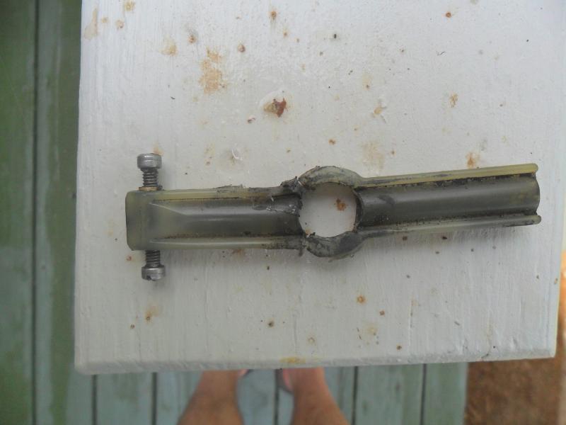

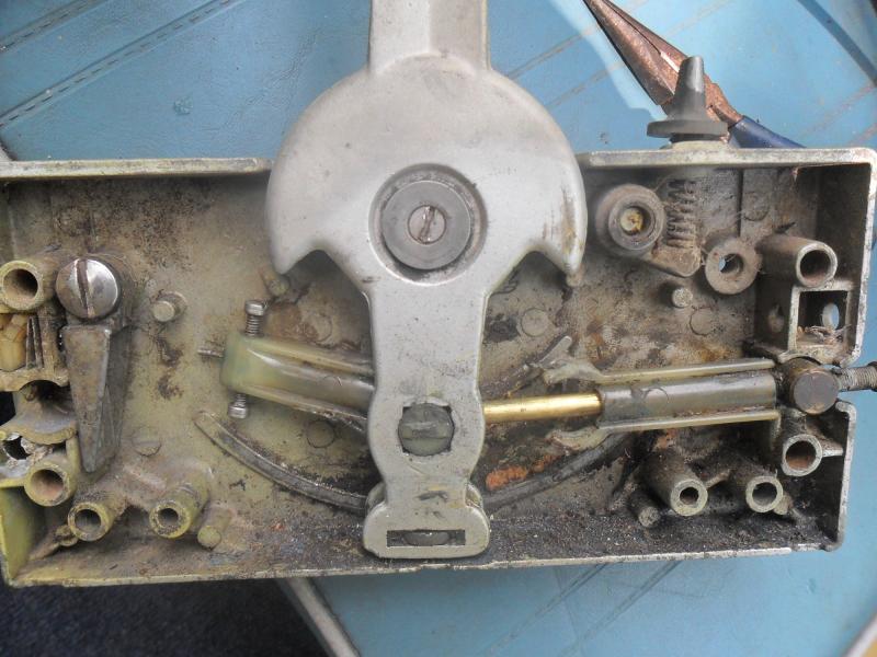

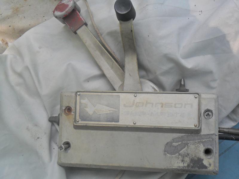

Hello, The other day while out on the lake my throttle controls broke for my 1960 40hp johnson. It is a two control shifter one for throttle and one for forward and revers gear. well the one that shifts it into gear broke not the cable but the plastic piece that the cable goes into.Would anyone no where I might be able to find this piece? I went to the marina down the road and for that year it does not show the controls with the motor. I don't want to buy the whole control set up if I can find the piece. any input would be great.

Your verbal description DOES NOT CLEARLY indicate which part you need. A part in the control box or at the lever on the motor.-------------Time to post a picture so that there is " no doubt "
Hello racerone here is a couple of photos maybe this might help. I am trying to up load but I am not sure how to do it, I do not no how to make it smaller.
Here are the photos racerone I hope this will help johnson controls 002s.jpgjohnson controls 003s.jpgjohnson controls 001s.jpg
Hello racerone , I what to thank you very much for your help I was able to get that part here at marine engines . I am so happy I did not have to replace the binnacles.:cool: Thanks again Paul
