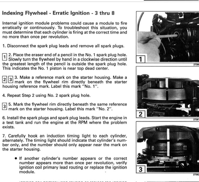

Here is a page from factory service manual.
From the service manual.
“Maximum Spark Advance Adjustment
No maximum spark advance adjustment is necessary. Correct wire positioning in the connectors is all that is required to maintain proper ignition timing. 4C/eng 1-42 “
My motor does not have the power it use to had. I rebuild it and has great compression, I changed the black box, the trigger and the captor that were failing. And i find out that it was blowind air out from the carburetor throug the air filter. Somewhere i read that the reason for that may be that it could be triggering the spark out of time. The plate housing the captor and the trigger has a screw regulation linking it with the accelerator and I think someone play with that. I though that regulation of that plate could be my problem of advanced o retarded spark fire.
