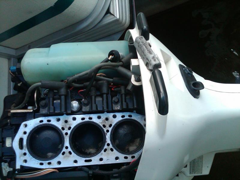

There is no head gasket on the 3 cylinder 35 HP motors ----------Just o-rings. --------Might be worth checking.
Johnson 35 Cylinders.jpgGuys-
Removed head. Everything appears clear and in working order.
