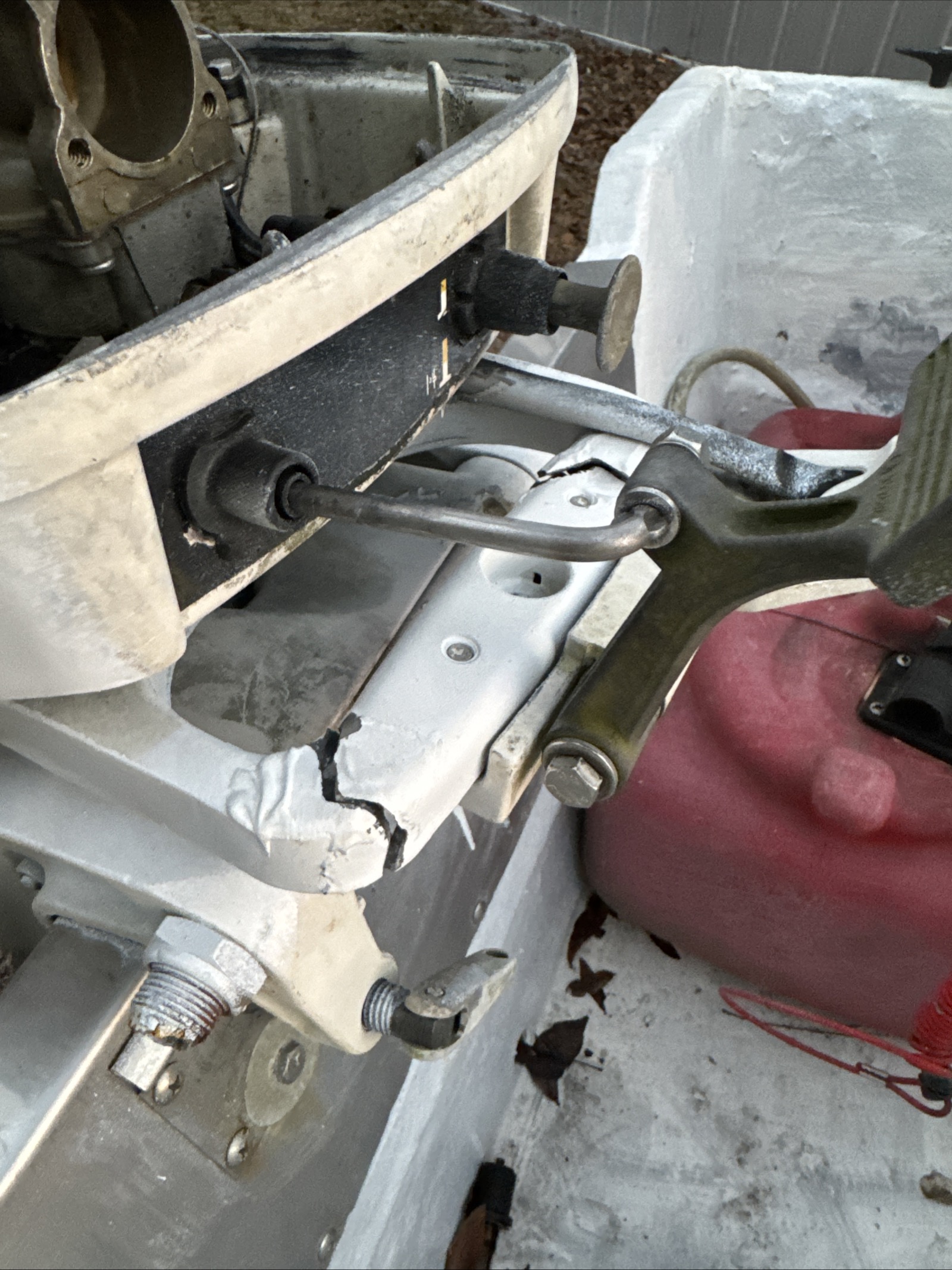

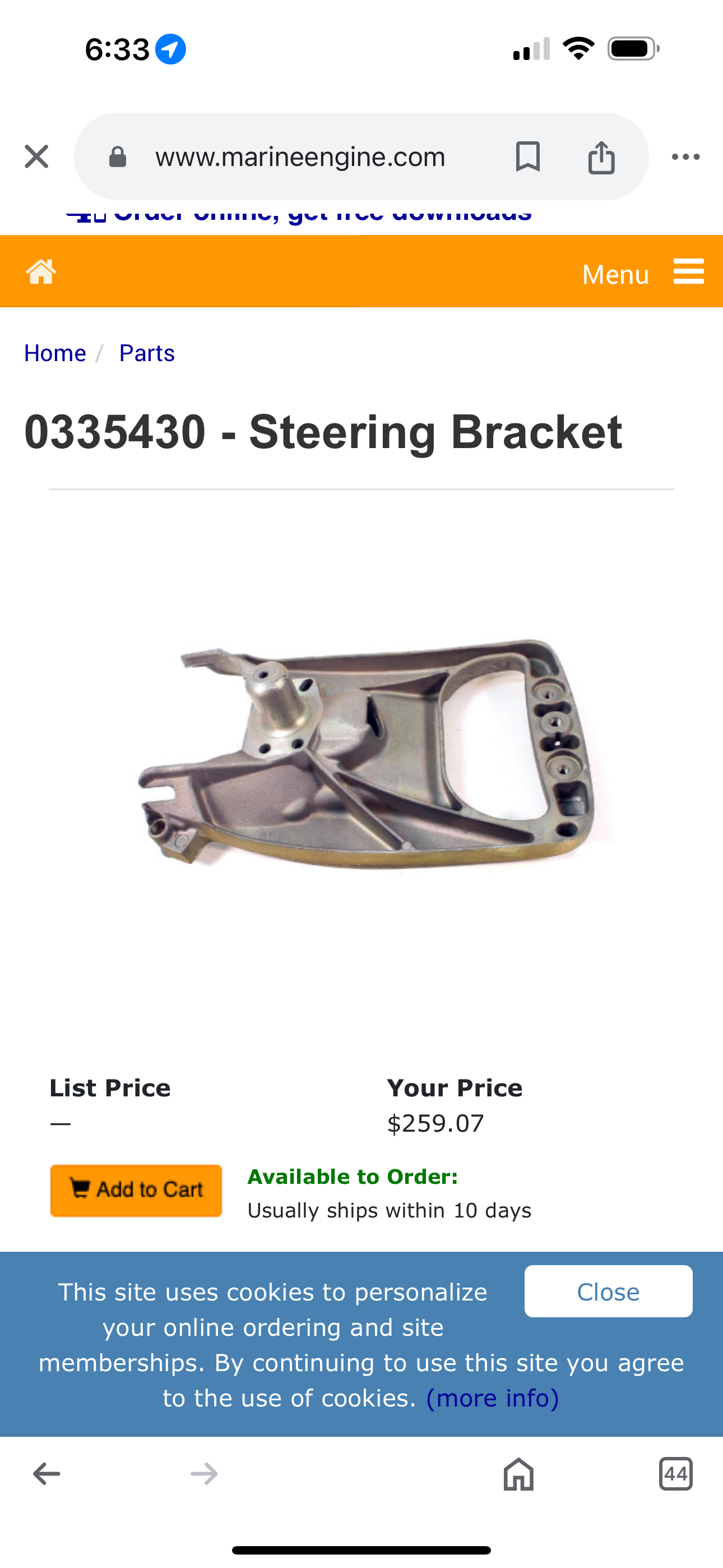

Pulling the powerhead off a Johnson 30 hp tiller handle J30reude. I have all of it unbolted and took it apart as the manual said, but it still will not lift. Do I need to take out the lower to get the splineshaft out of it? I’m trying to do as little dismantling as possible. I have to replace the steering bracket due to a limb falling on it during a hurricane we had.

It is possible that the driveshaft spline is jammed in the crankshaft spline, due to rust.-----Remove lower unit and see if it pulls down.----Good time to replace water pump impeller for maintenance.----How many nuts / bolts were removed for powerhead?
Hopefully you can find that bracket used for about $50 or less used.-----I sure would not pay that price in the first picture.
