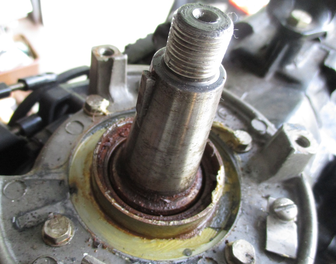

I have Johnson 1998 50hp J50PLEEA with VRO pump. When bought it seller told me about damaged lower unit.
I put engine on the stand and connected fuel, VRO tank, battery, BRP Side remote control.
Removed lower unit and attempted to start engine to confirm working condition.

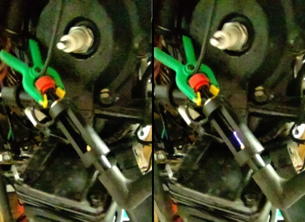

4. Removed each spark plug, connected rubber boot wire, touched the metal with spark plug. Tried to start - visually confirmed spark on each.

After few attempts to start engine would backfire with loud bang and fuel would drip from opening below where lower unit installed.
What can I do next? Thank you for your help.
