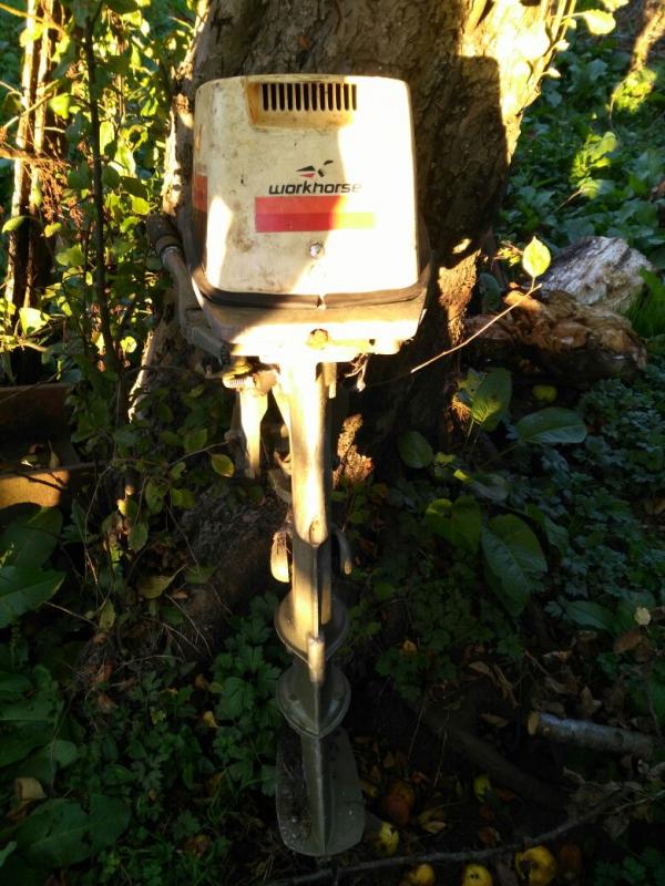

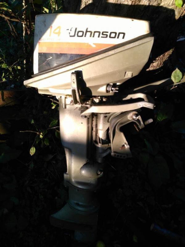

I attach some images of the engine.
IMG-20170404-WA0002.jpgIMG-20170404-WA0003.jpgIMG-20170404-WA0006.jpgIMG-20170404-WA0004.jpgIMG-20170404-WA0000.jpg
That is a commercial long shaft just guessing you have the 25hp gearbox of the same year. Call seawaymarine in lynnwood wa they have the best books. Normally the commercial have the beefed up gearbox but just guessing. It looks like the 25hp leg as well.

As stated in post # 2 you have the 15 hp powerhead adapted to the 20 / 25 HP midsection .--------Marketed as a commercial model.-----Engine parts are the same as an 88 model 15 hp.----------------Or the listing here for the J14 for 1988 model right here on this site / page ------Look for a box with ---engine diagrams ----top of this page.
