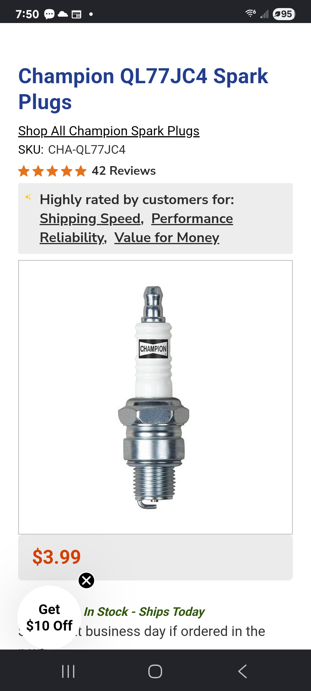

I live in Ireland but the marine parts direct is part of a European distributor and I can not get the Champion Ql82C plugs anywhere else.
Yes okay. I often use QL77JC4 also....gapped at around .030. they cost about $4 each here. I'm part Irish. Bucket list is come over someday.
