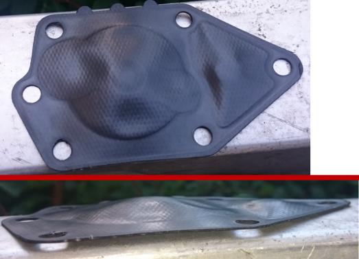

**I am a bit concerned that the pumps diaphragm might be worn out since its so stretched on the "pumping" areas?
Picture of the diaphragm in fuel pump:
Yes, I'd suggest replacing that diaphragm as long as you've got it all apart anyhow.
If pumping the fuel primer bulb corrects the problem, I suspect that diaphragm. However if the primer bulb has a tendency to be drawn flat... suspect a fuel restriction such as what follows.

I will try and find a replacement diaphragm.
