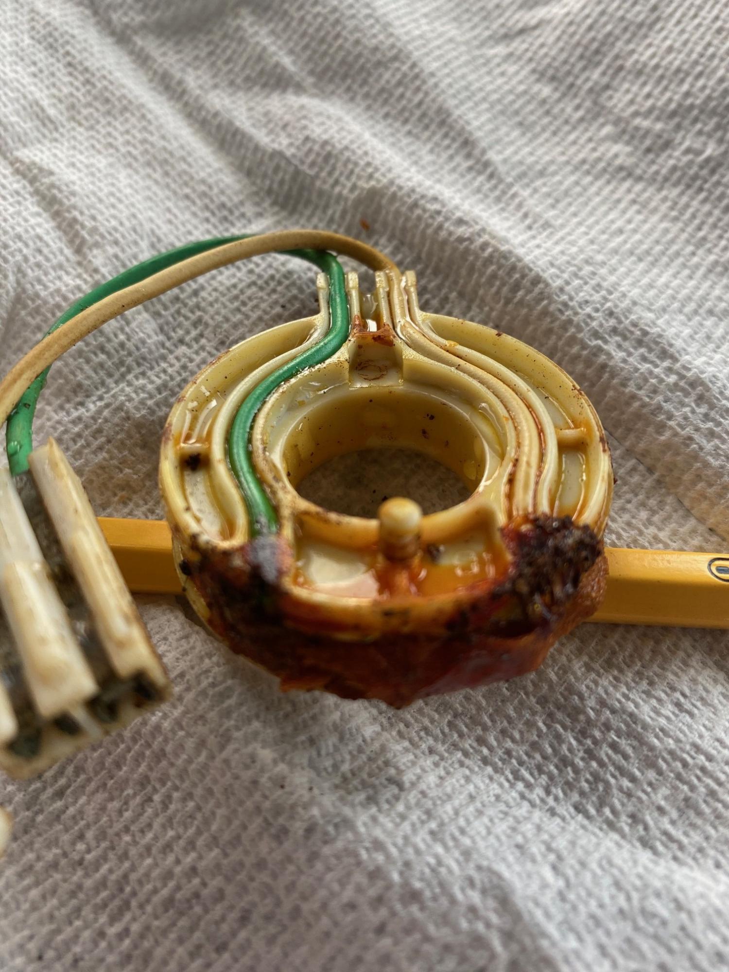

The picture is the ignition pick-up coil in the distributor of a 1992 Crusader 350 cu in
After a week of frustration with the engine starting sometimes and running sometimes and after changing the Distributor Cap/Rotor and the ignition Coil on the engine block I finally took the distributor out and this is what I found..
Replaced and engine now starts easily and purrs. The old coil had lasted 29 years.
