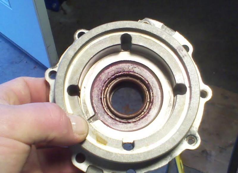

Hi,

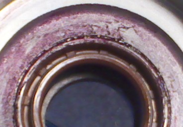

After replacing this bottom end cap crank seal I can't seem to get it to fit over the bottom of the crank without it trying to deform. In a very careful attempt the wire spring that runs around the lip actually popped off. It is very close to the right size but just won't seem to maintain it's integrity in order to slip over.
This particular seal I think is an aftermarket one, I have since ordered an OMC.. It is installed oriented the way I took the old one out and how I interpret the diagram.. before I waste another seal though - is it correct? (aside from the excessive sealer ;) )
Is the fit normally very tight over the crank? Was thinking next time will find a socket that is the same size as the crank and use that to guide to keep the integrity of the seal as the end cap is installed (and let the socked just get pushed out was I push the end cap on).
Thanks,
Jon

Yes, the seal is installed in the proper direction (spring facing inwards).
The seal part number should be 331103 for that engine model number.
DO NOT attempt to use seal #321668 which is superseded up to 330137. Possibly this is the seal you installed and the reason you're having a problem with it.
