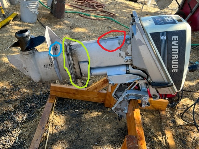

Main issue now is that the exhaust seems to be exiting through the small holes above the cavitation plate and not the prop (circled in blue). Additionally the area where the lower unit attaches blackens with oil after running hard in the tank (circled in green). I did replace the two seals on the drive shaft, but am wondering if there's more that I missed. Also I have water ejecting from the small port just below the motor (circled in red).

exhaust out those holes is normal. That black line looks like the water level in the barrel you used, might be wrong. If it is idling in a barrel you will not see exhaust out the prop. It will come out those little holes and higher up on the exhaust housing. if that is the water level line your water needs to be about 8" higher.

You don't have an exhaust blockage. The exhause system is the entire leg of the motor and down to the prop. You do have a carb problem, if it only runs with half choke on. I'd change the oil in the lower unit and then check it occasionally after having it out on the water. 2 stroke motors have oil in the fuel and it usually comes out in the exhaust and settles on top of the water when ou run it in a barrel. These guys know what they are talking about. They've seen it all. That motor just needs gas and oil and somebody to take it out and get it wet regularly. They're practically bulletproof! Many of them have been brought back from the dead over and over again! That's a keeper!

The mix screw should be 1.5 turns out. You don't get exhaust out the prop because you can't idle it high enough to build enough pressure to push the water out. Plus your water level is to low. If you ran it on muffs you would see exhaust out the prop.
Run that motor at 50:1----And in a barrel the exhaust comes out the idle relief !----Nature works that way.-----Air / water / wind always go for the easiest way to be balanced.----No need for a motor to do work to push exhaust down into the water at idle.

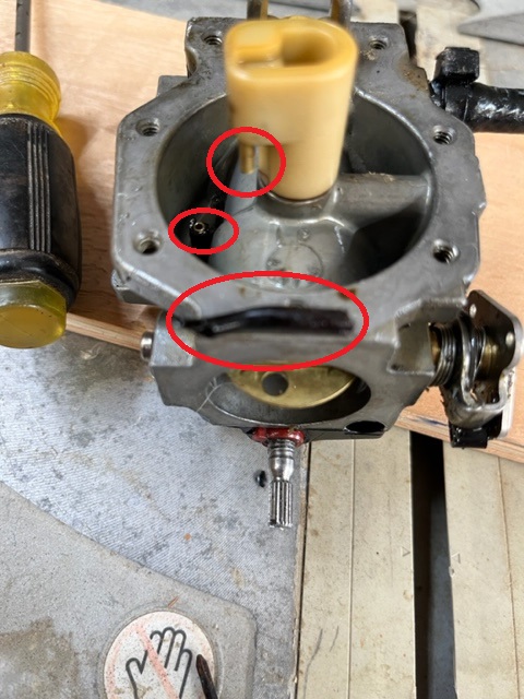

May have found the (or at least a) problem.
Removed the carb, removed the bowl and found this black tube laying on the bottom. Never seen this setup before but assume it's there for a reason. Ordered a kit.
Just an update should it be a value to anyone. Got a carb kit and put it in. With respect to the "tube" I found laying in the bowl, there was a flag on the order that talked about the enclosed tube not fitting, in which case order an alternative. Well, I got the tube on, but I think it's the wrong one. Anyway, going through the carb I found the line that this tube hooked to was packed solid with what I believe was rubber.
So, the result was that it eventually fired off, idled smoothly and accelerated great. I ran it hard in the barrel then let it idle down. It died and won't start. I think I'll order the correct tube, but need to decide if it's worth putting much more time or money into it.
Yes, I know a smarter guy than me would already have it running. Like I said, just sharing an experience should it help anyone down the line.
