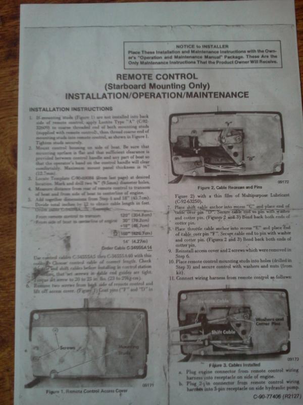

I NEED SOME HELP..!!!! I'm about to go batty with trying to get the shift and throttle cables in sync with each other where they will work . I am kicking myself for not taking a pic before I removed them from control box but water under the bridge at this point. I just want to get this figured out. I installed the throttle cable on the top spot (as per (haventaclue) as the mechanism does "pull" the throttle lever "forward" on engine as it's supposed to when you move the handle forward. Only problem with that is that it also "pushes" the throttle lever "way back" when you shift to reverse and try to throttle up,,,,??? when I install the throttle cable ON ENGINE, it binds up the control box,,,?? What am I doing wrong? tried lookin for something on youtube but no luck so far. I can manually move the shifter arm on engine and does lock prop in different directions when shift moved forward or reverse,,,,???? CAN SOMEBODY PLEASE HELP,,?
These are the instructions,hope they are readable
