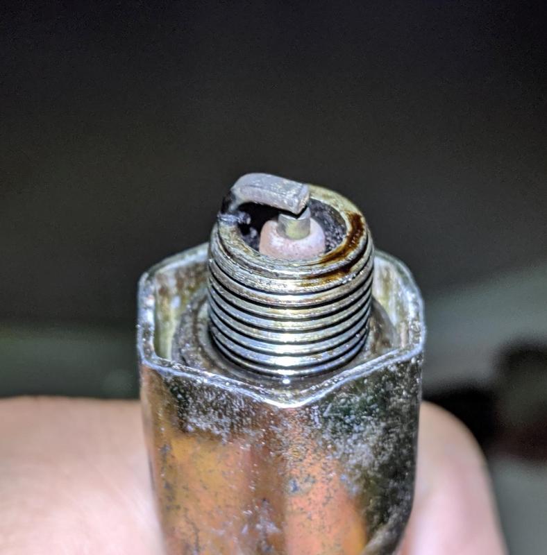

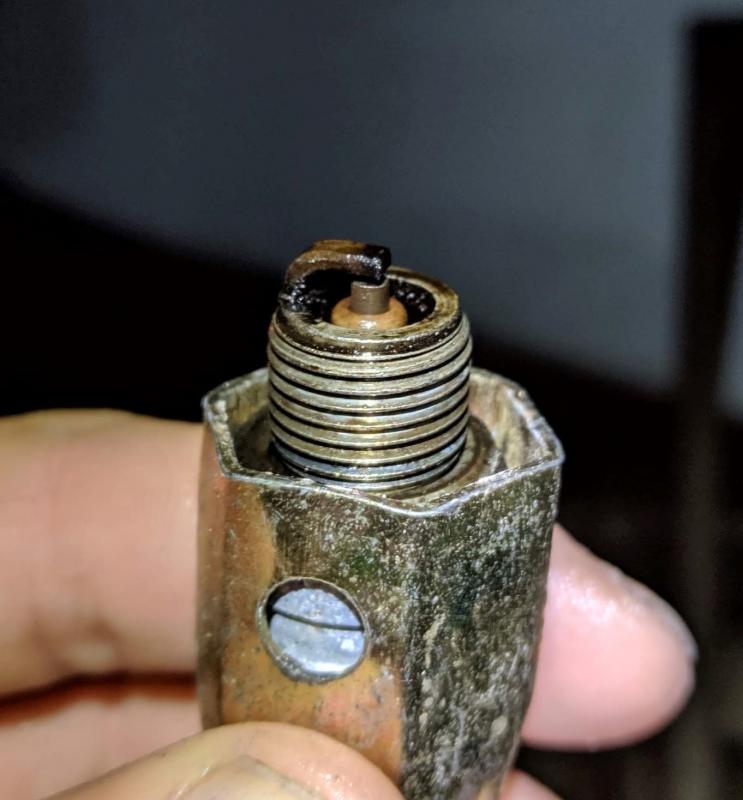

I've got a Johnson 15hp 2-stroke, model J15REEA. Sometimes I can get full power (you can feel the difference), but most of the time it's kind of weak and you can hear it almost sputtering at WOT.
I did some experimenting and found that if I do a hard left turn, where everything in the boat shifts to the right, I can get full power! Then if I do a right turn, it seems weaker. Straight forward is somewhere in between.
I'm thinking it has to do something with not enough fuel making it into the cylinders, and the right/left thing could relate to fuel sloshing in the carburetor bowl? Is this a simple issue of fuel starvation, or more complex like adjusting the carb float? I've got the shop service manual but am no expert with 2-stroke engines.
Any thoughts would be useful.
