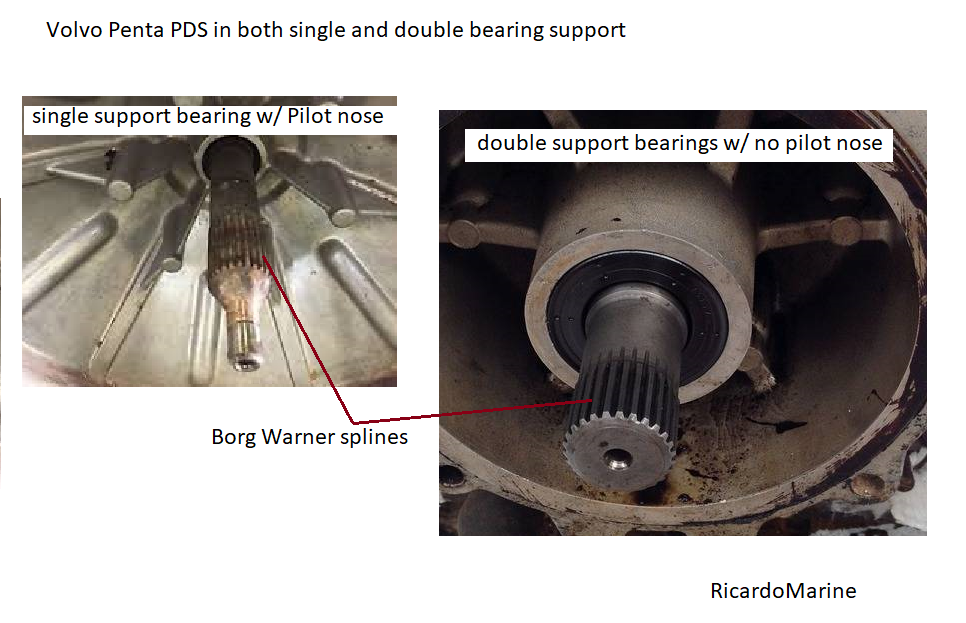

Tony, may I assume that by Intermediate Shaft, you are asking about the splined shaft that joins the Engine's drive coupler to the upper gear unit?
If so, and as I mentioned above, this is the PDS...... primary drive shaft.
Given your year model, yours is a single bearing PDS with a pilot nose.
The bearing is a sealed bearing.
The PDS will come out AFT once the transmission is removed for access.
You will need a slightly modified long needle nose plyers for the two snap rings.
The new bearing is nothing more than an industry standard 6206-2RS radial ball bearing.
You can purchase this bearing from most any good industrial bearing supplier.
Steer clear of the BBQ pork and Fried Rice bearings.
This is a fairly simple task.
