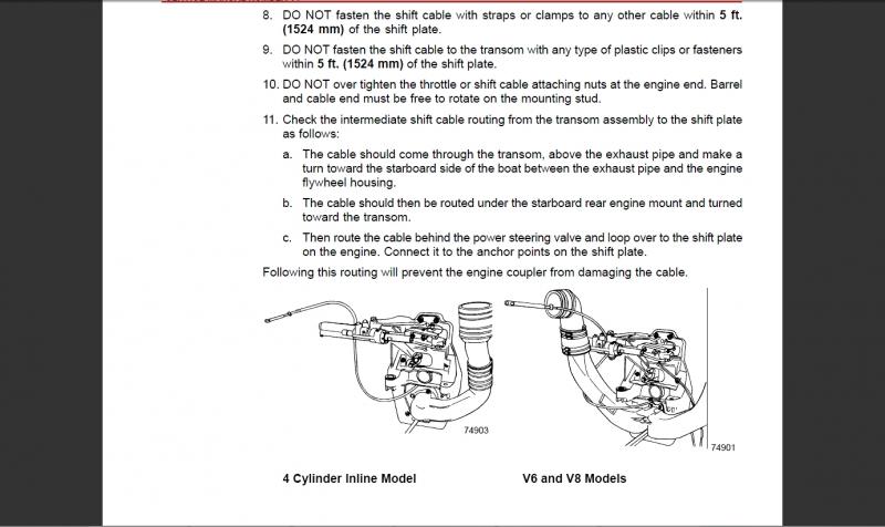

See attachment

Once thru the transom the cable housing bangs into the engine (Mercruiser 228 V8 305)- the correct path is route the housing to the stdb side up to the shift plate - once the cable is up to the top of the engine (rear) it has to make a 180 degree turn in order to line up with the shift plate - As you say it is a solid control cable - in my opinion it is impossible to tighten the brass fitting in the bell housing with the cable housing in this position. - just my opinion - l am a rookie

What I did next, once the brass fitting was tighten was to carefully route the cable housing up to the shift plate - (about a 45 degree turn from the transom) - l was then able to install the inner core wire.
The next problem I had was, I got the part number for the major shift cable kit from Mercury Marine. The cable housing was not the same as the original - the end was about 1 1/2 longer - I was not able to route this housing to the original path - long story short l saw that the minor shift cable kit had the right housing with the right end. Trouble was that the inner wire core was not the same - The inner wire core had a much smaller diameter - impossible to installed- I took the wire from the major kit and install it into the housing from the minor. I have it connected to the shift plate and the cable shifts smoothly - Sterndrive goes on tomorrow - I am a rookie at installing new shift cable.
