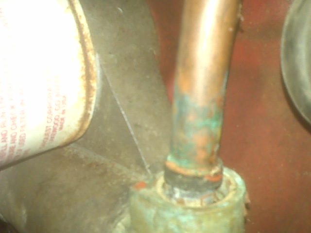

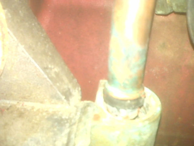

I went to start my engine yesterday. Aq130c. I had the outdrive submersed in water. When i started it water started to gush out from the inlet of the oil cooler. When I turned the engine off it looked like the piping came loose. Now there is a small gap between the cooler and the pipe and I dont know how to reconnect it. I dont see anything in the manual about connecting and disconnecting. Well nothing that would help. How and what do I need to do to reconnect the pipe to the oil cooler?
Those connections can be a bit of a pain in the rear, That particular one is best reseated by removing the exhaust manifold and getting to it from there. I'd also be wondering why it popped out. First guess might be that there was freeze damage but that doesn't seem likely in San Antonio. What does the water outlet connection of the oil cooler look like? Has the oil cooler taken a big knock and been tilted from horizontal?

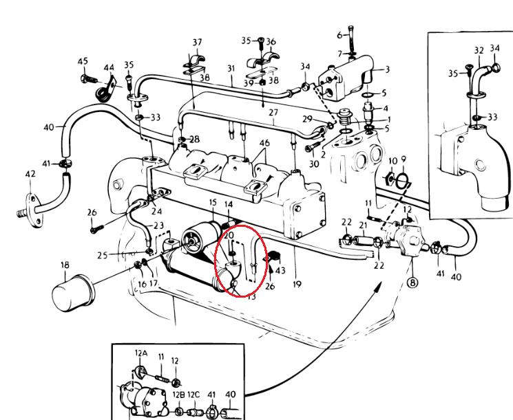

Look at your diagram again and you'll see that part 26 and 43 are the clamp and screw that anchor the line to the throttle cable bracket. When you're putting things back together be sure to get that clamp put back on. You'll want to do several dry fits before finally applying the red Permatex RTV to the new (square) o-rings.

I think some told me it could be freeze damage also. We did have a freeze here about a month ago. I have already purchased the water cooler gaskets because I wanted to change them out, and I went ahead and ordered the gasket for the inlet to the oil cooler. I already know Im going to have to change it before I put it back together. Im really not looking forward in removing the exhaust manifold. I just finished replacing the exhaust maifold exhaust pipe. If I dont buy a new pipe am I just going to have to bend the pipe back and then apply Permatex RTV? And about the permatex rtv can I just get that at the autoparts store? Or do I need to order it from somewhere?
You can get the Permatex red, high temp RTV, at most auto stores. Instead of removing the manifold, you can remove the pipe from the water pump at the front but you may need to remove the alternator. It's a process of bending and then fitting to make sure it's square and far enough down into the socket. Bend and fit, bend and fit, repeat as necessary. Be careful about those square cut o-rings. You want them to fit properly in the socket and not roll on you. Put a little RTV on the outsside of the o-ring before you put it in and then fill in any gaps on the top. A small screwdrive or something to smooth it out helps to make it not look so messy.

I'd really try to get it put back together with the existing tube than try it with another one that may or may not be bent up. You have to take things apart anyway. Hope I didn't scare you off about trying to bend the old one back into place. It's one of those things that are "doable", just need to think of the angles you're changing when you make the bends. It's one of the prices you pay for having an older boat but it's also one of the rewards. And just think, you can burn premium in your boat all day long and only be paying a fraction of the cost of the people with the big gas hogs!
Actually this was an easy fix. I ended up taking a crowbar and used it as a lever to bend it back into place. I did replace all gaskets and cleaned parts. The actual fix took 20 sec. Everything looks fine and its working great.
