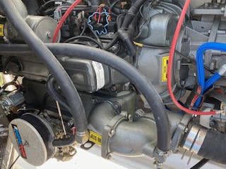

It has an interesting exhaust riser/elbow... It assembles from 3 identical right angle castings with gaskets in between each section and a spot for a water inlet on each section.. In the FWC version, there is a block off gasket between elbow section nearest the manifold and the next one. The result is that the first section ( the riser portion)
is in the FWC loop.... sorta like a copy of a Crusader.
