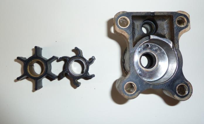

I dropped the lower unit to remove the water pump and everything seemed fine. The impeller however does not have straight blades as it apparently should judging by the pictures of a replacement impeller. Also, the axis of the driveshaft, and thus the impeller, are not concentric with the inside face of the impeller housing. That is, if the impeller is placed in the housing,the axis of it and where the dirveshaft would be do not line up. Is this normal? a defective housing?
Additionally, to check for blockages I took out the thermostat and forced air into the cavity. Air can be felt coming out the outlet (peeing) port and the tube that slides into the water pump housing. I can see the water intakes on the lower unit as well, so I know the blockage isn't there. Any other thoughts on a blockage?
