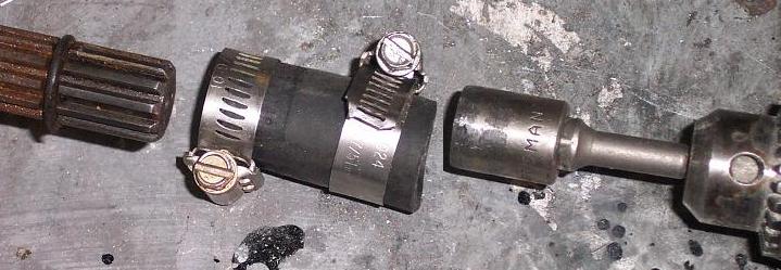

PS: I bucket test those LUs before going through the hassle of assembling them. Here's what the test set up looks like
thx Jeff
That is an awsome bucket test. You should patent it and go on the TV show Shark Tank. Try to get the Blond to sponser you, Laurie, she has great legs and is a looker. I already Did exactly what you suggested, as I stated in the first post, I know the post was long and a lil confusing, But I was trying to save you hard working contributing coordinators the time and trouble to have to type a lot like starting me off on this problem from scratch 1. I just pulled lower unit again and am in the process of trying to remove the power head to get at the top of the copper water pick up tube where I guess it enters the engine block. I was blowing some H.P. (100 psi) air up through tube and I pinched the pee tube and it lets a lot of air come out from that area. (the top of copper tube) maybe a lot should come out there, don't know, u tell me
) ( I hooked up my smoke test fixture, which is a piece of soft vacuum hose and me smoking a ciger and blowing the smoke thru the tube. (Somehow I can't see me getting any shark tank investors willing to sponser that invention, again I would pick Laurie, as maybe she could identify with it. )on that invention I think I ruled out restrictions and have a leak , somewhere. I am working on it now and will keep you posted. I am going to search for cliff notes on how to get that power head off.
ON severe overheat there is a plastic washer at top of the water tube it melts and blocks the water going to the powerhead. The pump is very simple and i
I never feel a need for testing them before assembly.
No there may not be an all the time need to test a pump before you reassemble, but there are circumstances , as In my case where a problem that you are looking for may mimic two different scenerio's. That and is happening to me now ..so when I get a couple steps completed I will run that pump on an air drill and if it pumps well at high speed then I can rule it out of my thinking. Do not take anything out of context, Your perspective is nothing but a help, and so is Jeff's bucket test when needed.
