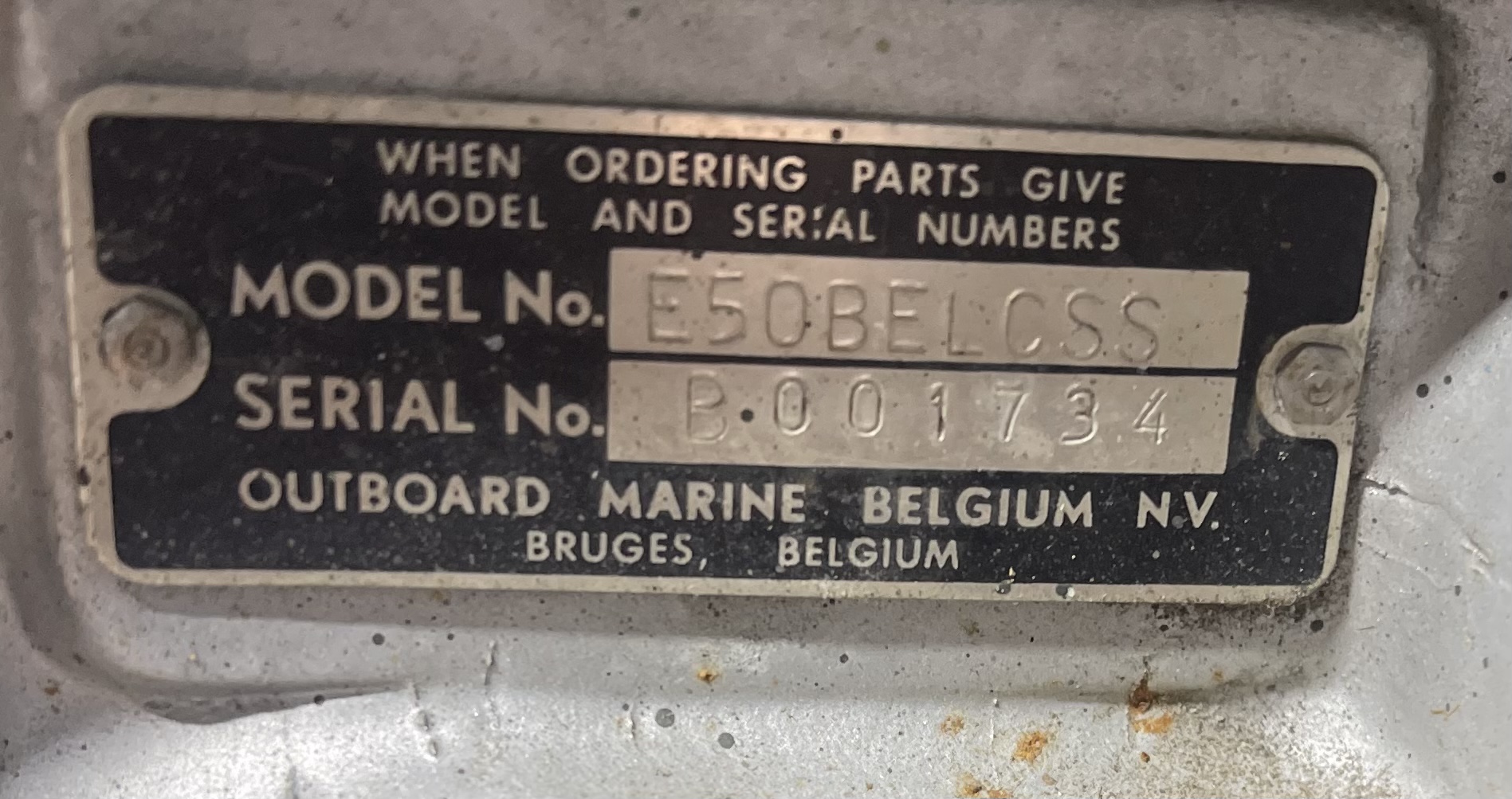

Just trying to pin down a year for the engine we have just picked up. Id tag shows model: e50belcss. We believe it to be a 1988 from this tag. But are unsure as the 1988 manual are showing different carbs to what we have.

So I was 8 years out with my guess. Not to bad
Well----sellers are often out by 10 years or more.----On occasion I see a seller listing a motor as a 1975 when it is an 85 going by the decals.
I agree it's a 1980. That last "S" in the model number is just the model run within the year. The year is the "CS" meaning 1980. You can compare what you have to the drawings here Model E50ELCSR (this should be the same. In this case that last "R" doesn't have any bearing on the parts.)
