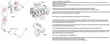

I have made a image and explanation on how to Manually winterize an Alpha Mercruiser. DO NOT SECOND GUESS these instructions. THEY WORK.
These images come from the 2001 5.0 EFI parts listing from this web site.
If you cannot read due to size Send me a private message with your email address and I will email it to you.
Nope,
The drive should be down and level so when you add antifreeze into Incoming water hose (removed from Thermostat housing) to back flush water out thru power steering cooler and out drive with antifreeze
Also with the drive down it self drains any water in the water system
Correction,
""Also with the drive down it self drains any water in the water system""
Having drive down allows DRIVE to self drain all water in the DRIVE system will drain out during winterizing.. Once complete you can trim drive back up if you want.
