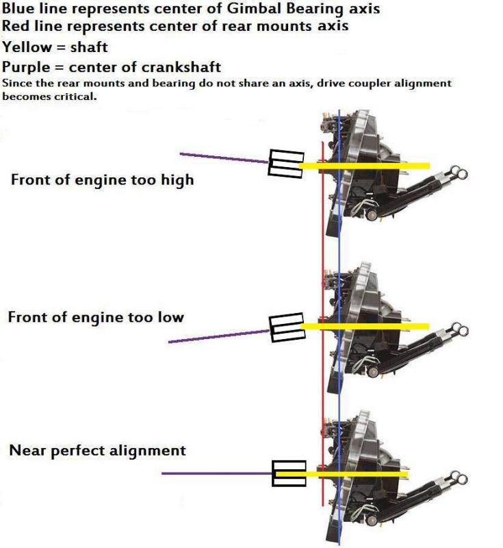

Here's what your goal is (see attached thumbnail view) while using the alignment tool and while adjusting the height of the front of the engine via the OEM adjustment stud/nuts arrangement.
