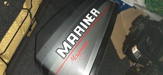

It's a outboard Mariner Magnum 10 HP, 2 stroke, made in Belgium. Need year to start to order some parts.

defectu, What does the decal in red say on the top cowling? Anything such as 10 HP Marathon, 10 HP Magnum, XR10 HP?..< Edit: Just saw it's a magnum engine...Here's a parts catalog for your engine model, http://www.marineengine.com/parts/mariner-outboard-parts/10-magnum/9596000-thru-9792199-bel
Can you post a photo of the sticker with the serial number in the location indicated like in the following link, https://www.perfprotech.com/images/merc-outboard-serial-number.PNG
10 Magnum Serial Number Range 9630000 - 9682499 = 1991.

...is the only decal
