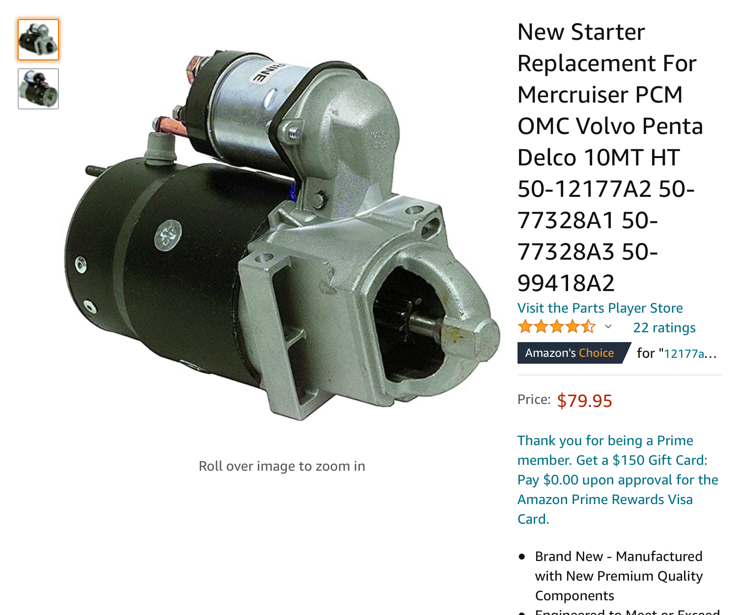

Thanks for the answer! I have a boat Chaparral 32. two engines on board. I figured out the engine markings and found a starter on amazon.
is this PM starter?View attachment 27752

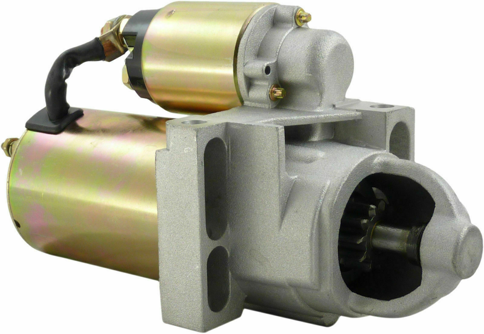

Ayuh,.... That appears to be the old style starter,..... it should look something like this,......
