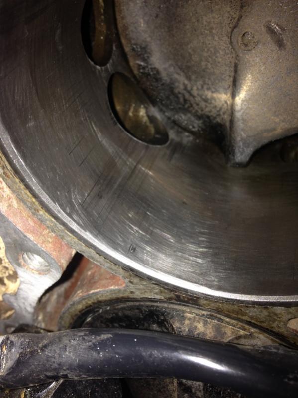

I have attached a couple of photos. The upper cylinder is scored but I think it will be ok. I am not really experienced with working inside of engines. I am more of a pull and replace components kind of guy.
Please tell me if I am wrong.
Head is warped. I sanded with 220 on a sheet of glass. outside corners clean inside not touching paper yet.
Keep at it?
I will confirm model but I recall J20CRCSA.

by the way I can feel the score at tdc but down a 1/4" I cant feel it but you can clearly see it.
Head bolts were surprisingly loose.
Watery oil in both cylinders.
upper cylinder has the score but the rest is good.
lower cylinder is all good.
Got hot enough to melt wire sleeve on cdi. Wires OK inside tho.
Good strong spark still.
I sanded for hours and it is flat now. Had to go down to 80 grit and work back up to 220.

Compression was dead even but I think the cylinders were leaking across.
The last place to sand out was between the cylinders.

The piston is damaged and that motor needs to come apart.--------There are no " band aid solutions " for that kind of damage !!

I can only hope it holds together a few more years. It is too rusty to spend any money on. likely very high hours too. Photo looks worse than it feels.

I just re-read. Your post. Cylinder walls are smooth. No Catch on fingernail at all. but I agree there is metal between the rings and probably a burr or two at bdc.
