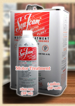

You can use Seafoam to soak gummed up parts. The MSDS for Seafoam states it is 40%-60% pale oil (thin, purified petroleum), 25%-35% Naptha, and the remainder is Isopropyl Alcohol.
If you buy a 1 gallon can you can pour it into a sealable container and soak your parts in there.
