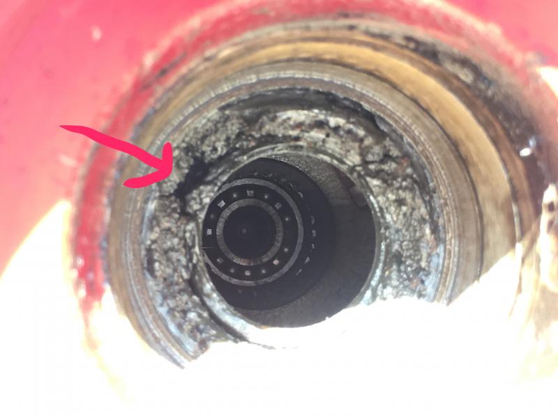

Also it looks like there's a 2nd seal in front of the bearing. So to replace this PDS bearing should be installing 2 seals?
I doubt that you will be able to gain access to the FWD seal from AFT....... but certainly give it a try.
BTW....... this will be a different seal p/n.
Thank you again for the reply. I'm getting it done little by little. Lol so I took the small snap ring off the PDS but I think the bearing is just rusted on. I'm gonna get some PB blaster today. So the cavity I'm talking about is between that forward most bearing and the aft PDS bearing that I'm replacing. It's a pretty big area. So that whole area needs to be prefilled? Here are some pics where hopefully you'll be able to see the fwd seal I'm talking about. It's sitting literally right in front of the PDS bearing.
Here's a picture of the seal.

What condition is the PDS sealing surface for that forward seal? You can stick the PDS in the pilot bearing with the PDS bearing removed and see if there is any slop in the pilot. Just above the forward seal on the top of the flywheel housing is a grease zert or a plug you can install a zert for pumping the PDS bearing full of grease. The reason the rear seal has the spring facing aft is it gives releaf for the grease to push through the bearing. I was able to put a speedi sleeve on the forward part of the PDS because the shaft was pitted where it rode on the seal. I did not want to buy a new PDS.
The PDS looks solid. A small amount of surface rust. That seal just forward of the PDS where the arrow is pointing in my previous pic looks to be the same size. So I'm thinking the area between the two seals is where the grease goes since fwd of that is the open flywheel cover. I'll look for a zerk up top. I just wanted to know if I should change that seal now. The shaft doesn't seem sloppy in it. It's just strange to me that the bearing on the fwd end of the flywheel cover is open to that dead space in there. I would figure it would have a seal on both sides as well. I don't really see any grease coming through the ball cage either.
