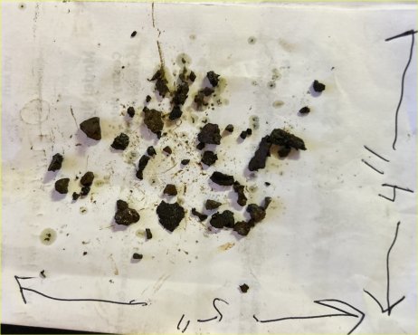

The first time I drained the oil I did so with the cap from the reservoir in the engine compartment removed. It was less than half full to begin with. The amount of oil drained was just over half a quart total. It wasn't dis-colored and no metal was present in the pan or on the magnetic screw.I removed the lower half only to change the impeller. Found no damage to the shaft or spline. Only the two bolts that were broke off in the housing which I repaired.I had trouble getting the lower back in by myself so I set it on a stand and removed the upper half.and got it bolted together. No damage to the splines or the shaft and the u-joints movement was fine. There was a small pool of gear oil in the main bellows (maybe 3 tbls) along with the small pieces of rust colored metal shown in the picture. There was no sign of water and the smaller bellows below were dry and clean. I cleaned the main bellows and used a scope to inspect the bellows and the gear the shaft goes into. Didn't see anything broken or torn so I rented a crane and put it back together., launched it, got up on plane and forced to shut it down and idle back to the dock due to the loud vibration and rough running.At no wake speed it was louder than usual but very little vibration.
As asked or mentioned earlier, when you separate the two halfs once back together did uou refill drive??
How to do it properly,
you remove lower plug and upper plug (both are slotted screws) lower near cone of drive and upper on left side just below top of drive. You now add gear oil from the lower hole til it leaks out of upper hole then install plug. Carefully remove fill line from bottom hole and insert plug. Making sure both have ring gaskets and they are tight. Then top off gear resevior which will drain down to about half after running as it fills upper gear case. At which time top the resevoir off again.
Sounds like you did not refill drive????
If you did not the there is a good chance the drive is toast
