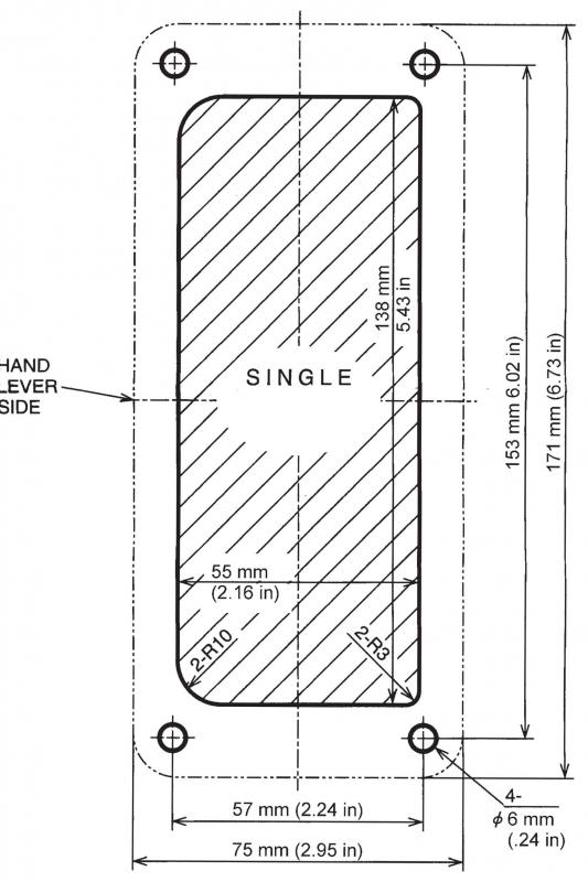

Teleflex also has a little nicer shifter, but has similar guts, that would connect the same way as the SL-1. Here is the installation manual location so you can see what is involved. http://www.seastarsolutions.com/wp-content/uploads/2010/05/CH1700_7500_7600_instruction_manual.pdf
The S model footprint is a little smaller than the Premium control, so you might have to make an adapter plate to fit over the Premium control's hole.
The newer version, above might be a better fit...although, probably more expensive. You should do very a close comparison before you make your decision.
Here is the template for the Premium mount. Hope this helps.

Hondadude,
This is a perfect solution, and your help has given me a direction to solve this problem. For about $400, I can make this change and feel a little better about the gears not getting ripped out of the motor, which would be a 1500-2000 ordeal.
