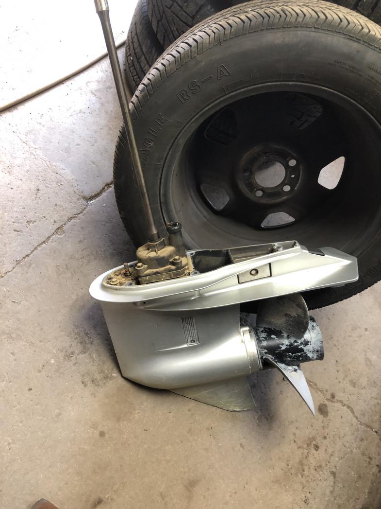

Looks like I solved this odd overheating issue. As I stated earlier I am a auto tech by trade, so getting a little dirty wasn’t a concern for me. So both thermostats were replaced, the plastic thermostat cover on the engine block was leaking water, so I replaced with a new cover which just happened to be made of metal. I also replaced the 3 coolant sensors as they were only $16 each to remove them from the possible mix. The pressure relief false is under the lower plastic cover on the port starboard side of the engine. I removed and replaced that as well. I next replaced the impeller and all associated parts (I bought it as a kit). The pee stream was good before, but it was WAY stronger when finished. The boat went out and ran for 3 hours and ZERO overheating issues!! All in all we had under $300 in parts, and labor was about 2 hours in total. Given I had never done this before I am confident I could now do it in an hour or less the second time around. I hope this helps some of you guys with high rpm ONLY overheating issues.

So, if I were to do this over again, and in the interest of “less down time is a good thing”. I would order the following parts. Two thermostats stats (remember they are unique to their given location, I.E. different temps, DON’T mix them up!) two thermostat covers and seals. I would also replace the pressure relief valve and seal. It is the item in the first & second picture, and looks similar to a thermostat. As long as your impeller is good (two years old max imho) you should be good to go!
