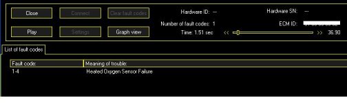

Getting the infamous DTC 1-4 HO2S (Heated Oxygen Sensor)(Abnormal HOS2) error
A little history: Recently revamped my VST (new Fuel pump Filter, O-Rings), refurbished Fuel Injectors, new Thermostats, New Low and High pressure Filters, O-rings etc. Current state: engine runs a little rough, if I RPMs from ~1500 quickly down to idle, it might die out. And after engines runs for ~ 5 minutes I'm getting repeatable 1-4 DTC error. Not sure if this is pertinent but, If I increase and decrease the RPMS seems to exacerbate the error.

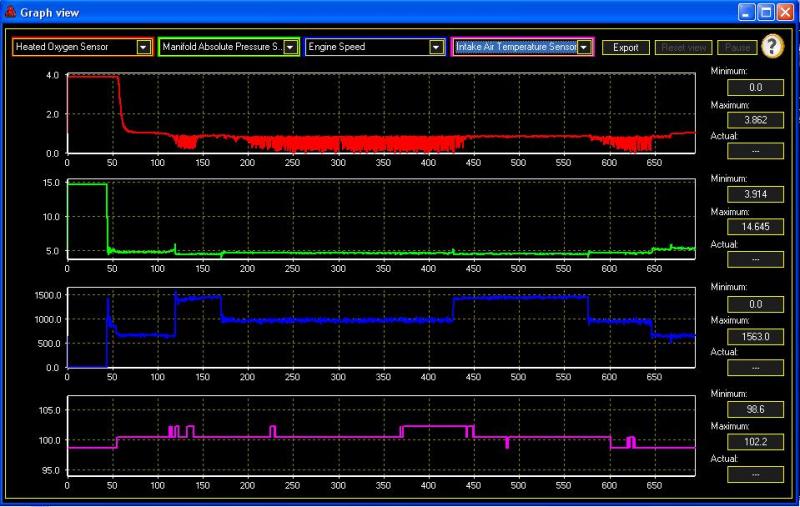

H02 sensor, (I think, appears to be working): Voltage fluctuates between 0 and 1 volts.
From the Graph View does the 02 sensor look like its functioning properly?But Error comes back....
