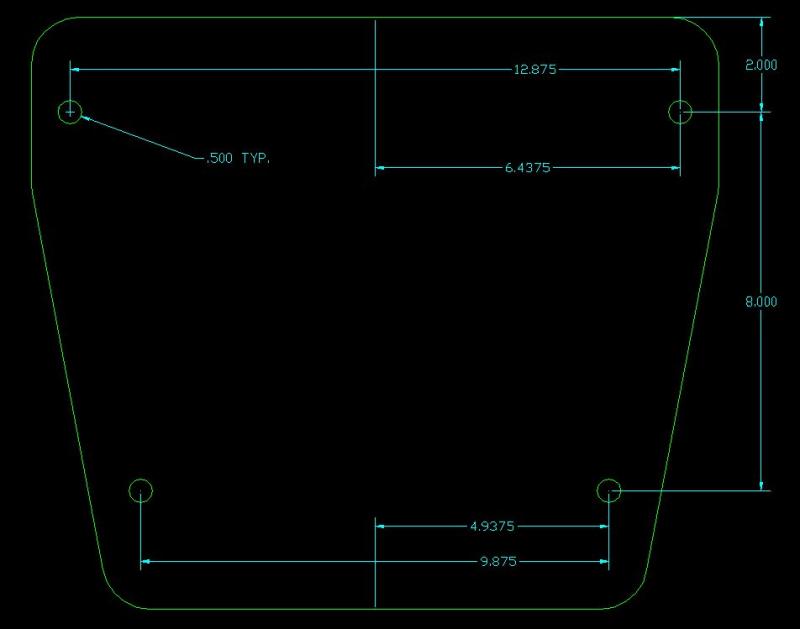

The BIA pattern follows this outline:
All holes are 1/2" diameter
Top holes
-- 12 7/8" on center
-- 6 7/16" from the center line.
-- 2" down from the cap of the transom.
Bottom holes
-- 9 7/8" on center
-- 4 15/16" from the center line
-- 8" down from top holes
The attachment is a CAD drawing of the pattern. If your holes don't fit this dimension then something really odd was done with your boat.

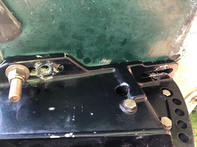

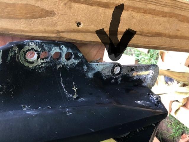

The holes are there but they are cast in the aluminum almost as if they should be threaded and bolted from inside. I'll try to get some pictures.

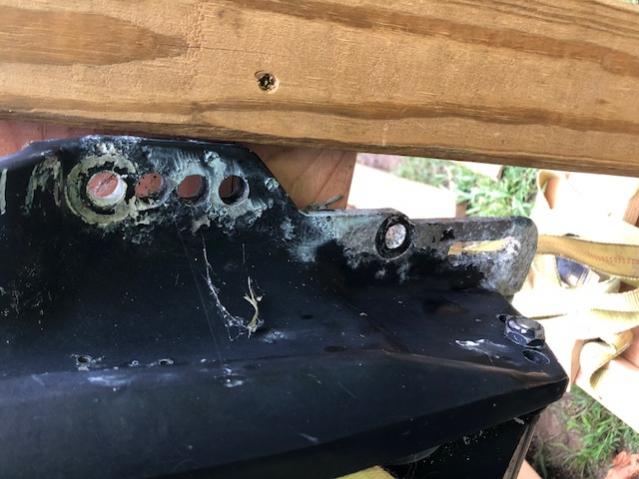

If you compare these two photos you will see in one photo there is a bolt hole just above the slotted holes. And in the other photo that hole is not there. envirude new.jpgevinrude old.jpg
The older transom drilling template. Maybe they've eliminated the alternate location????
Curious, I've never seen the alternate location but you're right, those lower holes look like they match that pattern. I can see how the 90HP definitely wouldn't use that mounting point.

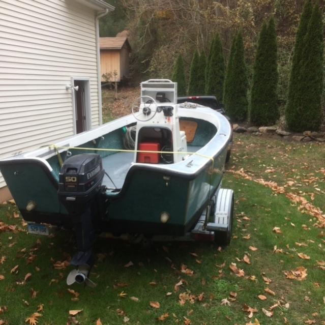

It's raining right now, I will try to get some better pics. But as you can see from the style of boat cutting into the floor is really not something I want to do. And I will have to call the manufacturer just so see if there is any room under the floor or if it is full of flotation.little boat.jpg
What brand of boat is this?
I'm really surprised the 50HP doesn't push that boat well enough. You won't win any races but should be able to go about 30MPH.

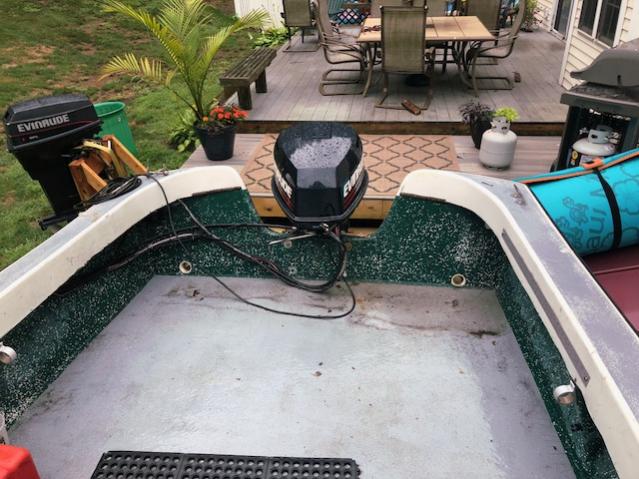

A picture from inside the boat toward the engine would be great. Also, can you measure the transom height, that seems awful short unless the picture is deceiving my eyes.
It could be full floatation under the deck, but in one of the pictures I definitely see a drain plug in the transom. Unless there is some odd structural thing with the floor and foam I really think a bilge well in the back would be a great addition. It would give you access to the lower mounting bolts and you could install a bilge pump (a must on every boat in my mind).
I will get some more pics when the rain lets up. The boat is custom, it is Rosbo. I just picked it up in the fall. I did some research on the company, it was two brothers. This one was built by one of them and he has passed away but the other brother is still making them. Now they are called ROS and are built by Coastal Boatworks in RI. If you google ROS Boats you will find them. It is really a neat little boat. It is very beamy and heavy for a 17'. The 50 was OK but with three guys going blackfishing it would barely get on plane. It is rated for up to a 115HP.
What size is the hole in the motor ?----Can you put a 1/2-13 NC thread in them.-----Those holes may have been there for the shipping crate / box that they used to use.----And yes you can thread a bolt in from the inside.
Good catch. That may be the OP's best choice.
Okay, I see how the deck is made. So are those drains on either side of the motor? That's pretty interesting, do you get water coming in there?
I got it on the bigger motor. If you're rated for 115HP, the 50HP is waayyyyy under powered. I like to run a boat at or near max rated HP so the 90HP should perform much better for you.
No water. They have the "Ping pong ball" scuppers that stop and water pressure from the outside. As for the 1/2-13 NC Thread, I am considering either tapping those two holes so I can use them or using some JB Weld and putting some studs in those holes so I can fasten from the inside with a nut and washer. Just not sure if the JB Weld will hold.
