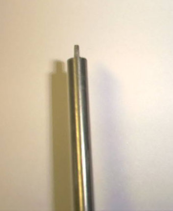

You maybe can make one if you are talented and have suitable tooling to do it. I made a bunch of them and I can tell you that it is surprisingly difficult to make a screwdriver. The secret to the jet screwdriver is the flat sides of the blade must be parallel. Off-the-shelf screwdrivers have tapered blades, which tend to spread the slot in the soft brass jet. That means the harder you try, the tighter it becomes. End of the story is you then wind up drilling it out.
OK, OK, sure it might come out easy and none of that angst applies. How's your luck?

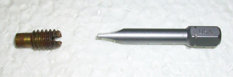

I bought a few of these a few years ago. Being hollow-ground, they are almost parallel, good enough. I'll look tomorrow to see if I have any left. I'll let you know by PM if I do.

The hollow ground bit that I pictured above is part number 5944A43 from mcmaster.com You might as well just order one direct from them. They don't cost much at all.
