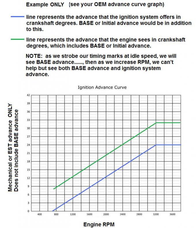

2. Plugs, points, wires, are new, but I only timed it at idle (850 rpm). I'm not sure how to do the 4,500 timing,
You will increase RPM as you continue to strobe the timing marks.
Write down the advance numbers at varying RPM info in graph form.
(see my example below)
or the dwell.
A dwell meter is required for this.
