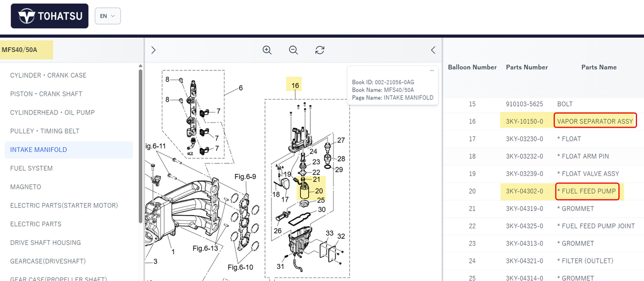

Tohatsu does not think so. The high pressure pump is located within the vapor separator tank.
I can not imagine changing out the entire vapor separator tank if just the fuel pump within has failed.
Which is why the fuel pump is offered as a spare part. It is more than likely the most common part to fail. Except for maybe the filter.

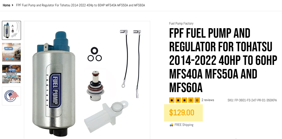

For those that are daring and on a budget, non-Tohatsu pumps are available at a very reasonable price.
There is usually crud in the tank causing the FFP to fail, and then the whole thing is changed. Yes, it's possible for the pump to go... I just haven't seen it... That IS indeed a good price...
The voltage draw on the aftermarket pumps is different than what the ECM can supply. So, that burns out the ecms. Never trust an aftermarket fuel feed pump.
