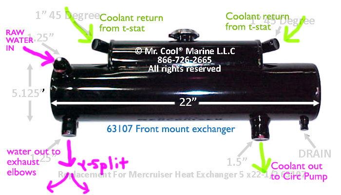

I backed myself into a hole by not taking enough pictures, and don't have allot of experience with fully closed system.
Long story short, moved from rear to front mount and ended up with a front mount Seakamp 63107 which has slightly different ports than the original Crusader HEX.
My questions are, in this diagram, is the in and out water and coolant flow correct? And out of curiosity, can water flow in the opposite direction, in through the out door? I thought I saw something about parallel vs. cross flow, which one are marine heat exchangers?
Thanks again, the knowledge and willingness to help on this forum is awesome.
