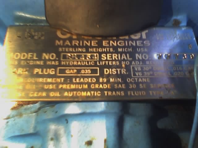

As far as what rotation engine you have, look at the serial number plate right below the timing plug on the flywheel cover. That is the definitive reference for an original engine.

makomark, thanks for the info. Will there be a R or L in the serial number? Looking at the flywheel on the Starboard motor it does turn to the right, or clockwise. My survey says that my transmissions are 1.91, but the mechanical survey states that they are 2.91. If they are 1.91's, will that make a difference in what you posted? The boat is a 1987 Chris Craft 426 Catalina turning 24" by 26" props.

The sequencial number part of the engine SN should have a LH or RH in front of the five digits. I posted the page out of that vintage owner's manual a few weeks ago. I think if you search for "serial" on the crusader board, you'll find it (search function at the top.)
I attached a photo of my ID plate on 89' 7.4's, the "RH" is indicated in the model info. Hope this helps. Also hope the attachment is here...
