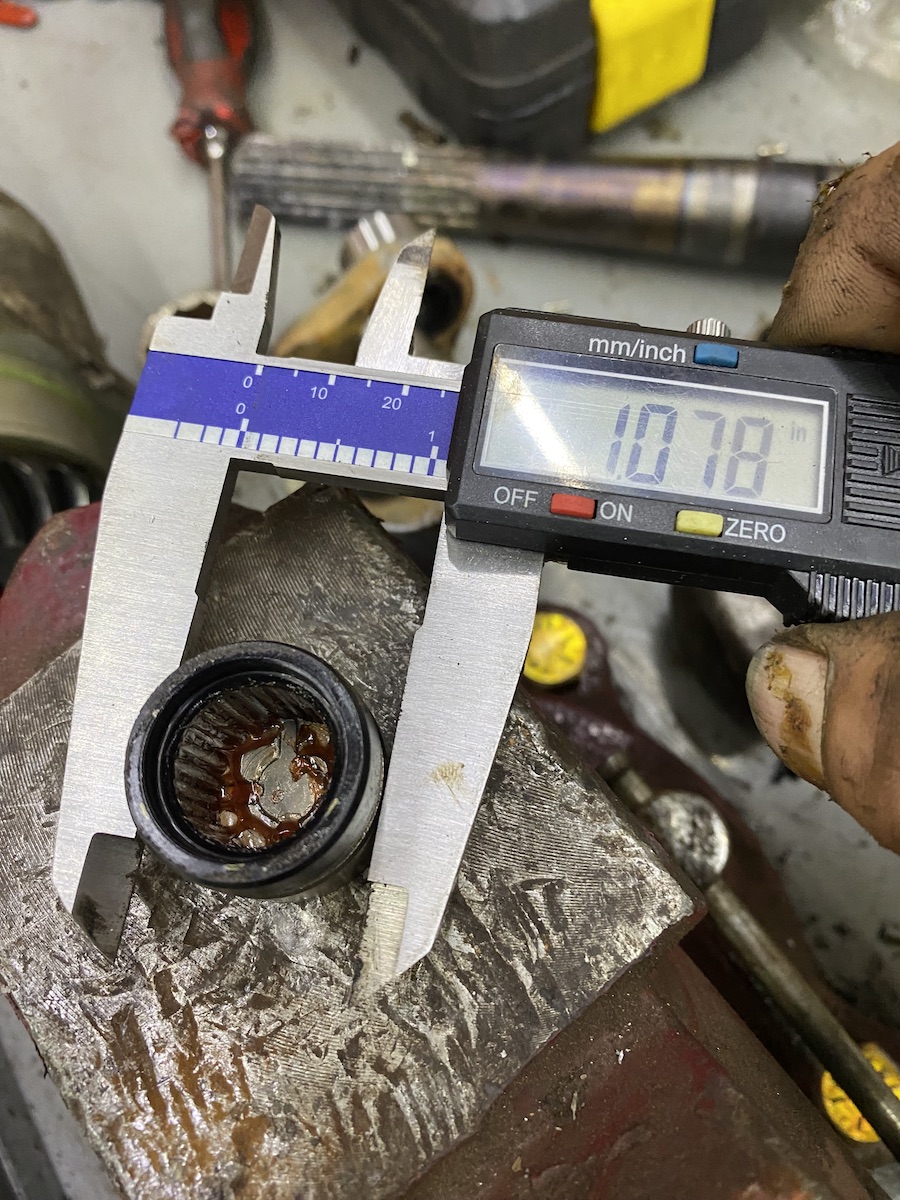

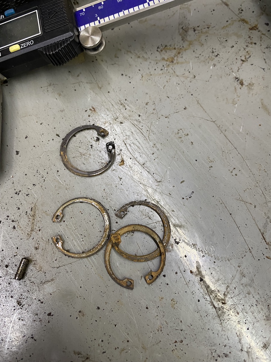

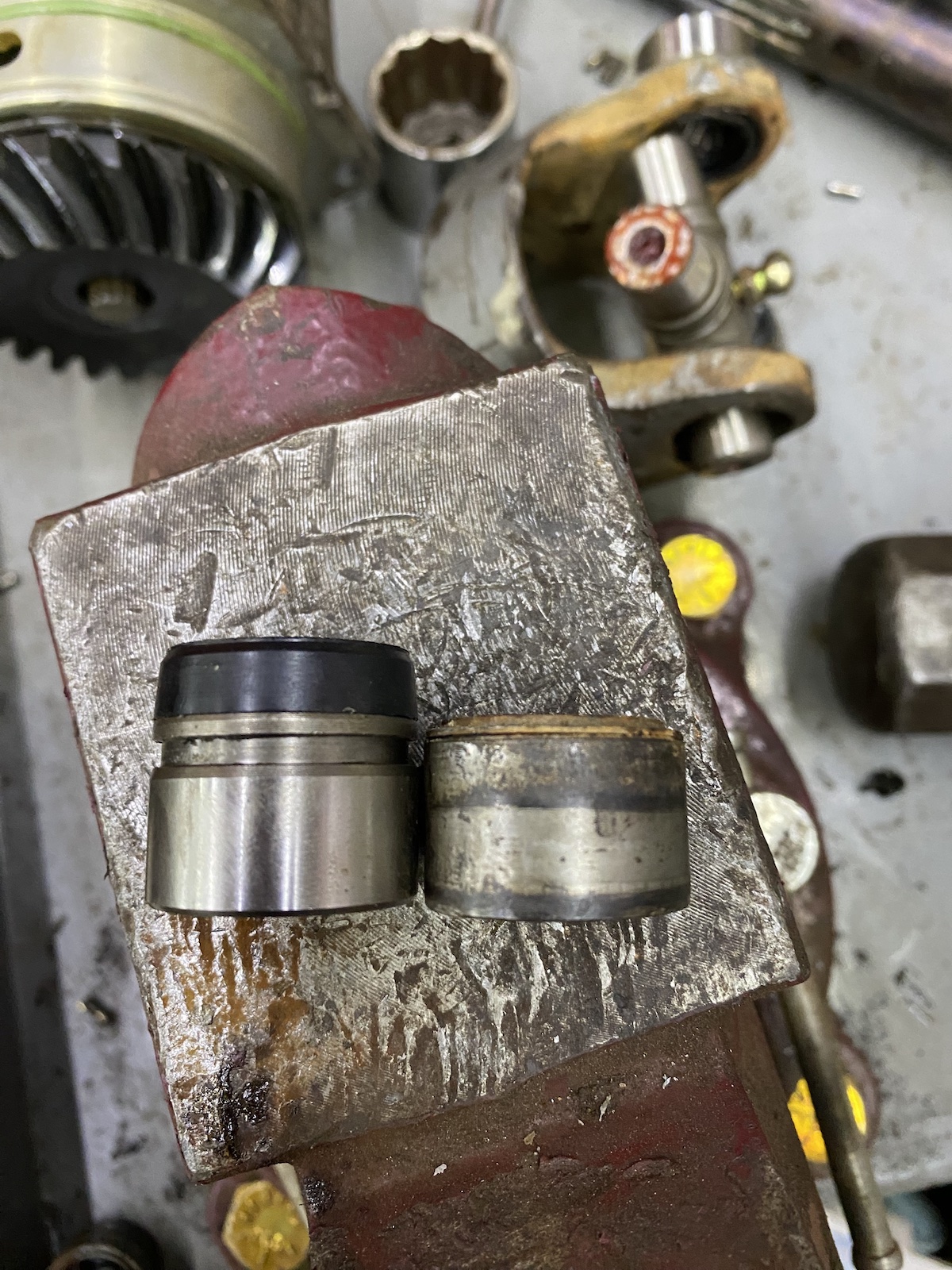

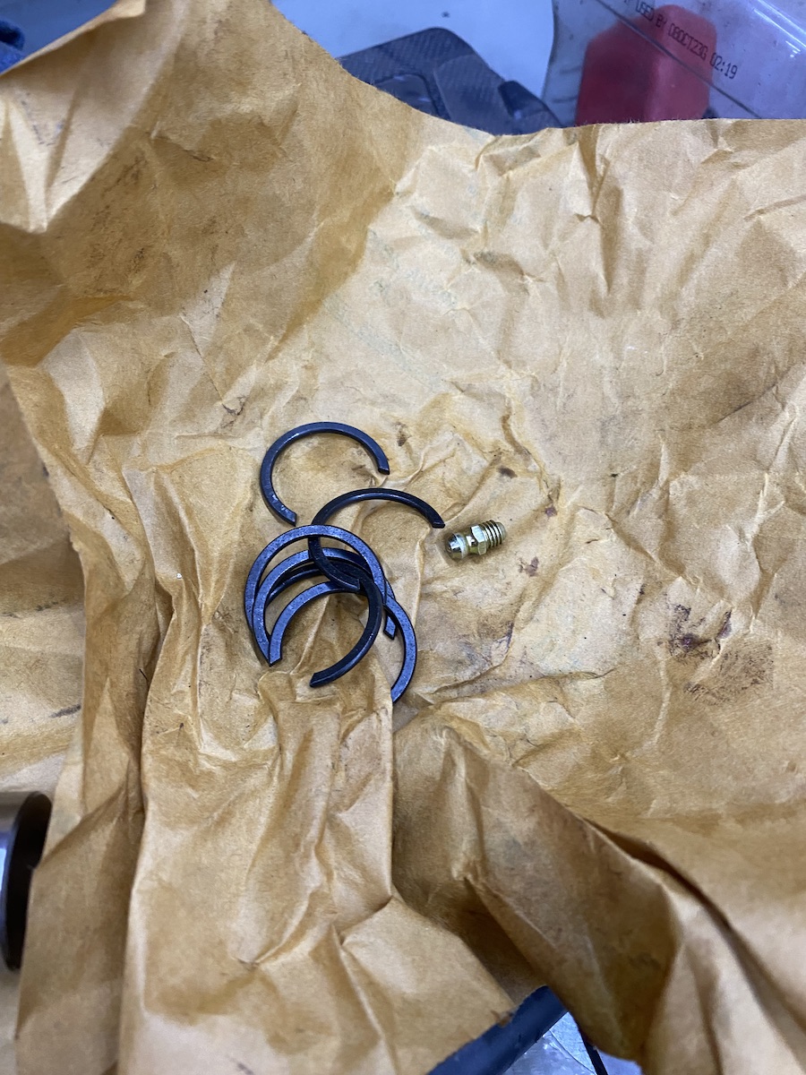

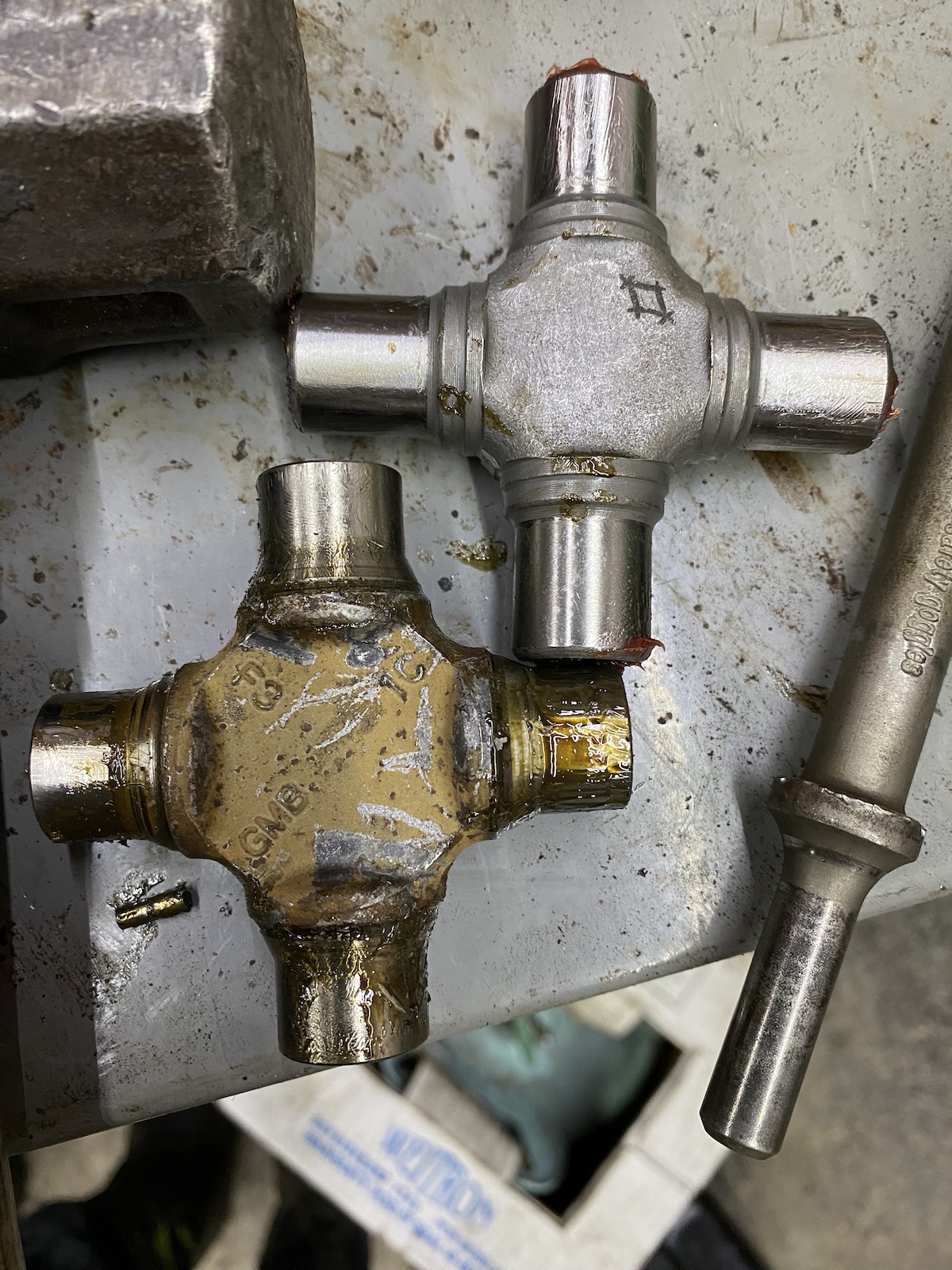

The photos everywhere I look on the internet show the the u-joints I got from a vendor. But it's not what we got in the drive. My only other crazy theory is that in prior ownership someone swapped out the entire yoke that matches up the same with other lower units but has different u-joints. I found a good deal on a OEM yoke for $420 and am wondering if that is the best way togo. Have you seen variations on the u-joints when cracking open older units?
Just trying to figure out how best to solve this. My mechanic buddy (cars but it's done his share of Merc products) is as much as I trust a good mechanic but as you can imagine with no V/P experience..he doesn't really know the variations...and relies on me to get the numbers right!
Thx.
additionally, he sent me photos of what I ordered (again looks just like the ones I see in the retail photos) but you can see the one he's pulled out!
Looks like you might be caught up in a U-joint assembly change out over the years and it isn't recommended by Volvo to only replace the spiders but the whole assembly though if you do a deep online search between a few boating forums, some have been able to just change the spiders both by either using some from volvo or going to either an auto drive line shop or have NAPA auto, etc. match up what you removed though some say some brands are to short and needs shims which you don't want to do or others are to long/tight causing potential damage too.
Plus, if i see in the photo correctly, your tech may have removed the bolt that may require a new crush sleeve on some models and a volvo penta rolling torque method.
Plus, the size of the bolt is important and comes in a kit as mentioned in the service bulletin from Volvo link below for you.

Ok, met with tech today. I think we are confident that the part number for the whole new shaft will work and based on the V/P tech article you sent the part number for the spider only is wrong and prob shouldn't be R&R'd anyways.
I'll confirm the new sleeve and bolt mentioned in the article comes with the new shaft or need bought separately and the tech said he'd review the video...he's fully confident on what is need accomplished there. Hoping for specs from the video we'll both watch this evening or to find the specs in the V/P service manual PDF I have.
