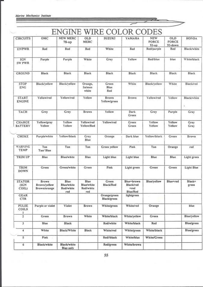

I definitely need help in properly re wiring this outboard. I am having problems with hooking my tach, monitor gauge, fuel, and fuse panel to my shifter. When I received the motor everything had been cut. I have a manual but i am mechanically not electrically inclined. I do have the motor finally turnin over but the the motor is in the on position when my ignition is still in the off.
