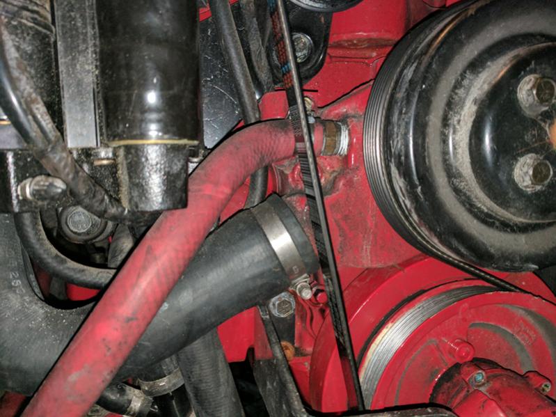

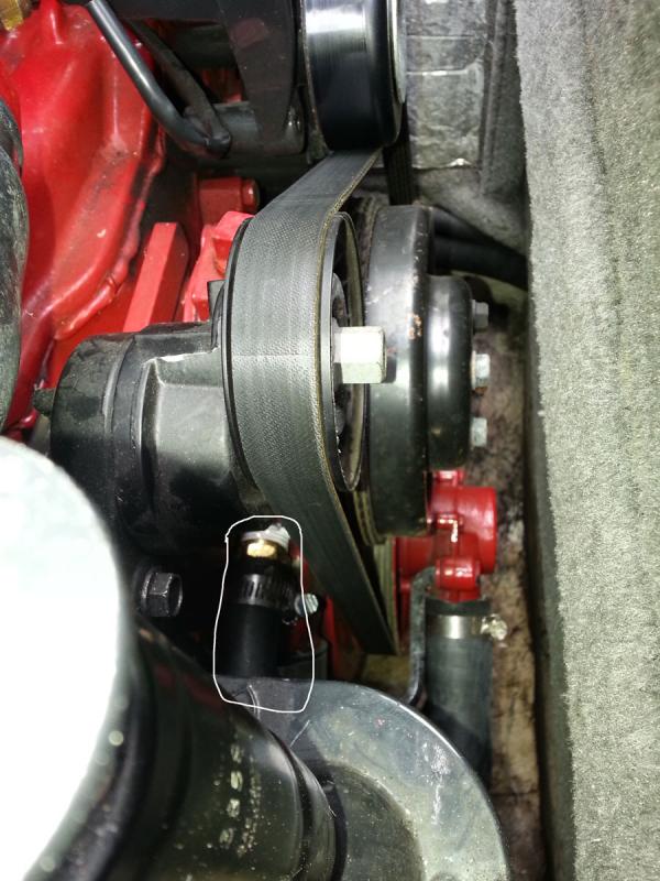

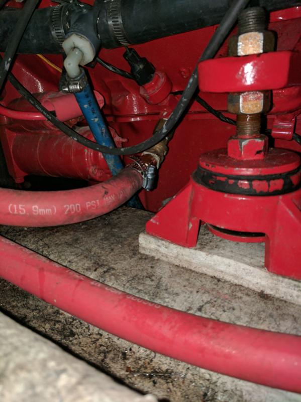

Hi Rick,
I was away for a couple days but yesterday I decided to check the hoses from the heater end... make sure that was no air trapped and that water was flowing... I unplugged one hose (one coming from the 9' of circ. pump). Run the engine and there was water coming from the supply hose and it was running through the heater and water was coming out on the other end where I had unplugged the return however, I was surprised that I also had water running from the return line.
I put my finger to plug the return line from the circulation pump and when I gave a little gas (increased the RPM) the pressure built up on the return line and I had to remove my finger and water was running.
I think that both lines are working as a supply therefore there is no circulation.
Thoughts?
Here is the pictures where they are plugged.
Fred.................
Image #1 is correct.
If image #2 shows a connection to the front intake manifold port (within the cross-over chamber), it too should be correct.
(see attached image)

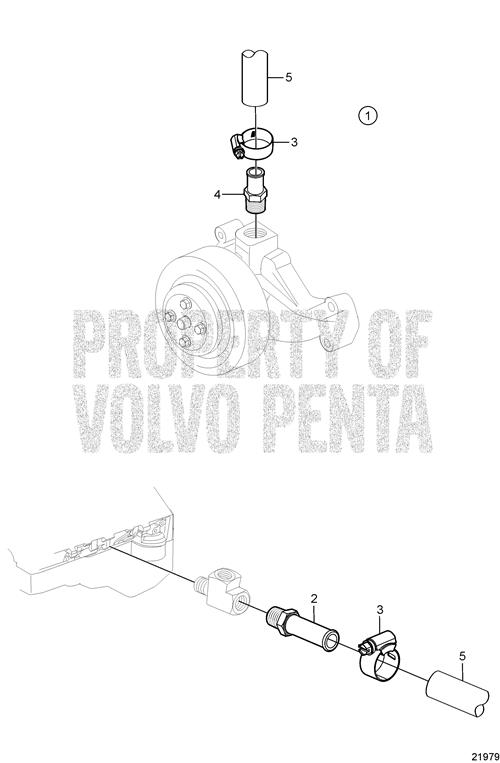

Ricardo,
Can I connect the supply where this plug is (beside number 19 on the figure)
http://www.marinepartseurope.com/en/volvo-penta-explodedview-7746090-26-10059.aspx

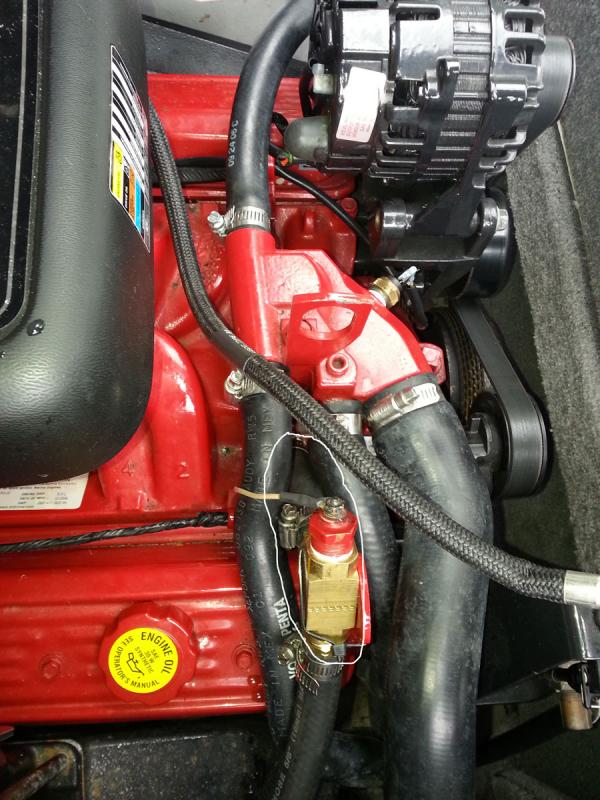

I can confirm that the Penta diagram below illustrates the correct heater connections. I have a boat that has a factory installed heater. I came here to determine how to properly reconnect it. The Penta illustration below showed me where to look for the coolant connections. Upon matching the factory installed hose lengths and the obviously plugged ports I was able to confirm the illustration. The hot coolant supply connection is the nipple number 2 in the Penta illustration located low in the middle of the block on the starboard side. The coolant return connection is nipple number 4 in the Penta illustration on the water pump however mine is not connected to the top but rather a port on the starboard side of the pump. I assume either is equal for functionality. The Penta illustration combined with the assumption that Reinell would connect the heater in accordance with manufacturers standards I believe this to be the best configuration for the Penta 5.0GXi.
I disagree.......... it demonstates an alternative method.
Perhaps read post #2 again!
Again, this is an alternate method.
I could not suggest doing this!

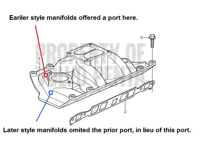

The warmest engine coolant (exiting the cylinder block/heads) will be from the intake manifold port where the coolant has passed through both the cylinder block and the cylinder heads.
The thermostat holds back coolant giving it the mild positive pressure that is necessary for a good working Cabin Heater or Water Heater!
The CH or WH must have the necessary "balance" between pos and neg pressure. With out it, we will not see good coolant flow!
(see this image again)
[url]http://www.marineengine.com/boat-forum/attachment.php?attachmentid=6685&d=1367259588[/URL]
That would be the engine circulating pump.
That would be correct!
Not quite, but either will work!
These ports are directed into the suction area of the circ pump body.
It may be the only configeration if the Intake Manifold does not offer the port prior to and to the Stdb side of the T-stat housing.
NOTE:
The cylinder block port shown being used for the coolant supply (first and second images) is only 3/8" TP.
The 3/8" TP threads and corresponding hose fitting will restrict coolant flow.
The intake manifold port (not shown) is typically 1/2" TP and will be much less restrictive.
The third image shows the correct suction port connection.
