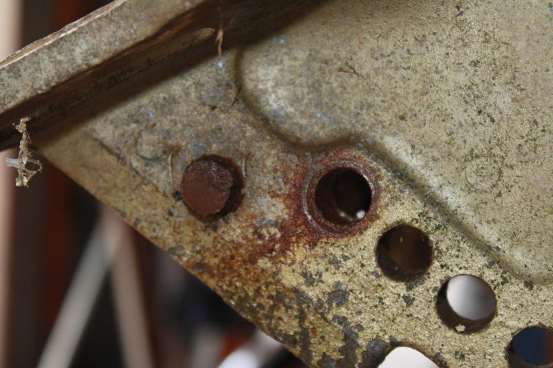

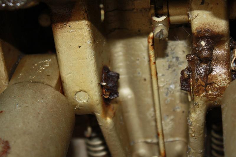

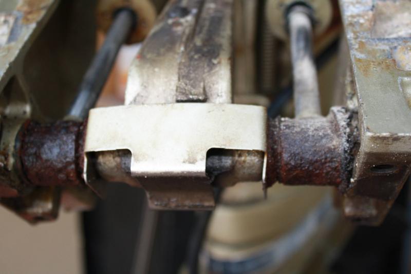

hi guys i have an 85 hp evinrude an oldie the tilt tube is badly rusted and needs to come out it seems to have two nuts one either side of the transom bracket but they are inset into the brackets and the lock nut is the only one you can use a spanner on ony ideas would be appreciated thanks warnie 004.jpg005.jpg005.jpg007.jpg006.jpg
I don't understand the question..... You only need to remove the lock nut. The one in back of it is simply a spacer with no threads. The threaded one on the other side can be removed when you slide the steering tube out in that direction.
thanks joe it looked like it was screwed in both sides i will try a little tap or two i am a little woried about the strength of the alloy parts thanks again
your right about that kim bugger of a job thanks for the ideas and will attack in the next few days gotta get more heat thanks again warnie
