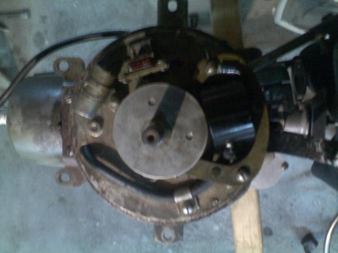

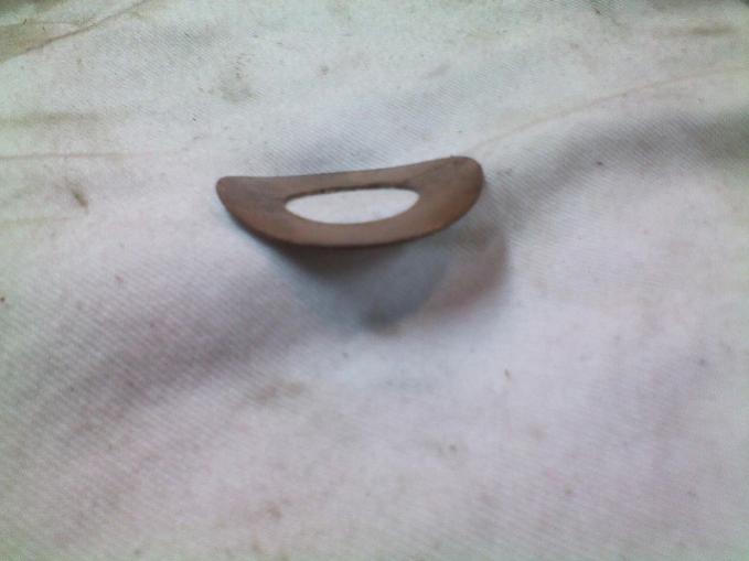

I took the flywheel off today and took a couple pics for ya. Maybe you have some good advice for me. Also when I pulled the flywheel a brass washer fell off. I know where it goes, I'm just not sure which WAY it goes. I also took a pic of it. Does the edges go down against the magneto with the center up against the flywheel (that's how I put it back) or the other way around???

Ok now I see how the water gets there. Yep That is what mine looks like buddy. Are these water pumps prone to go bad? anything I need to change? Sorry for being dumb about all of this. Carpentry and woodworking is my forte.
