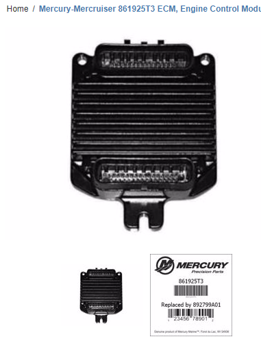

HELP-- Need an ECM 861925T3 2000 Mercruiser 5l
dtventures
Contact Duane 250-808-3131
Its NLA for the Mercruiser part and its replacement...
Best bet is to check with one of the rebuilders/repair shops. Get the Delphi number off the back of the old one and start there... the good shops can program it to work with your engine...
have heard good things about boats unlimted on another forum never used either one
If I had one of these I’d probably just convert it to a 4bbl marine carb either Holley or Edelbrock. It’s a bit of money but then no more hassles with NLA parts….
If you can get the Bin file for the ECM, it can be copied over to the new ECM using MefiBurn. In short, if you can find the correct Bin file for your 5.0 and find a ECM for lets say a 8.2, the ECM can be erased and reloaded with correct file
