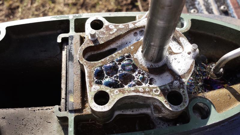

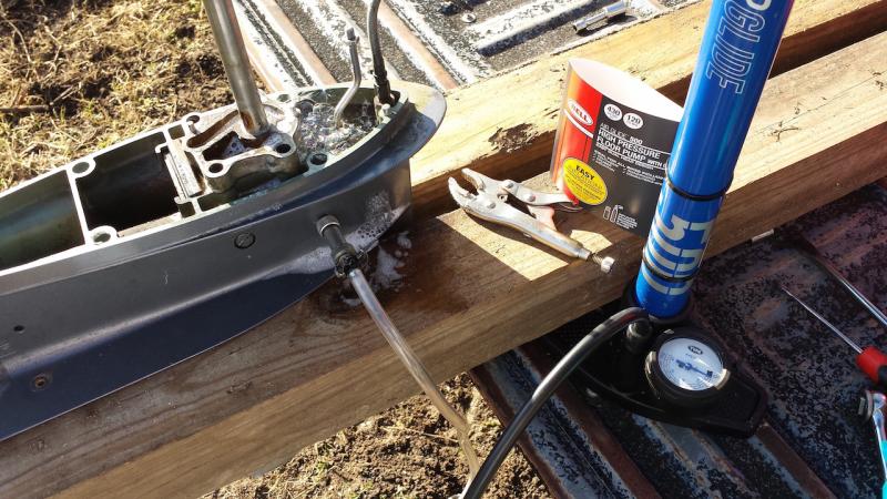

So I remove the lower unit and pressure tested it at 10psi, I noticed bubbles around the shift shaft seal/boot and the drive shaft seal. The good news it there was no leaks/bubbles around the prop shaft seal.

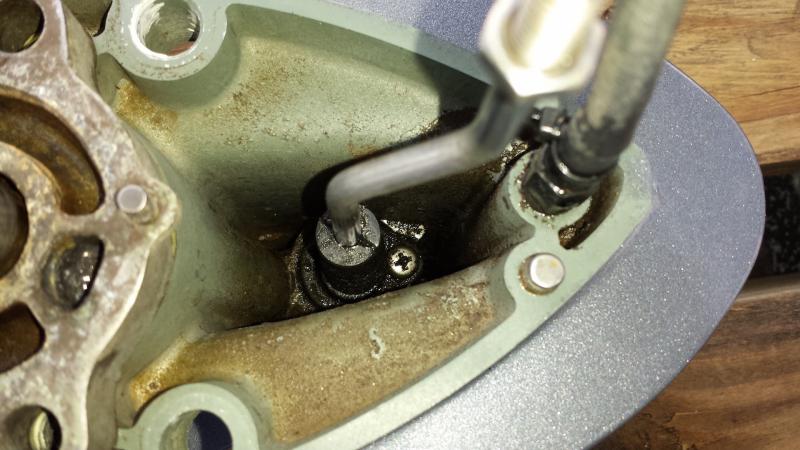

I removed the black plastic water pump housing, metal cup, impeller, metal wear plate and gaskets. However there is a metal base to the water pump (from the parts diagram it is listed as part number 663-44341-00-94 HOUSING, WATER PUMP) it has two dowel pins stuck in it. HOW DO YOU REMOVE THIS PART, it seems pressed in to me, I do not see any bolts or screws holding it in place?
I have attached some photos.
Can I replace the drive shaft seal and shift shaft seal myself or should I just take my lower unit to a yamaha dealer and let them do it.
any advice will be appreciated.
