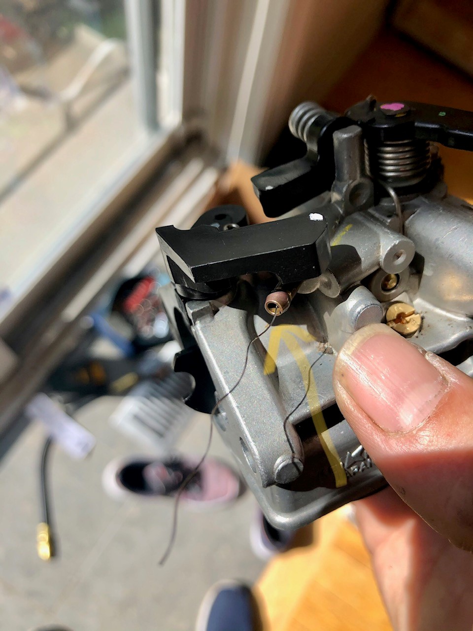

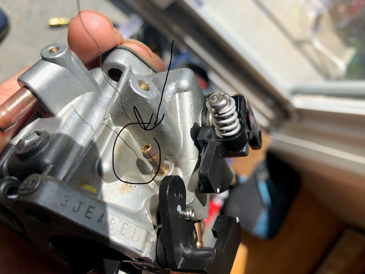

I have:
- checked fuel lines (disconnected each and blew air through)
- Removed and inspected fuel pump. Looked fine, metal bit had good spring to it and retracted with moderate force
- Checked the carb, took it apart, cleaned it, inspected/cleaned needle valve (looked perfect)
- Checked for spark - it has spark (enough to give me a bit of a tickle anyway) - going to get a spark tester to be sure
- inspected fuel filter and pick-up in tank. Clean.
- Inspected sparkplug. Looks darker than it should be but not so much that it would prevent a start I'm thinking
- Inspected kill switch and unplugged it from coil pack for kicks, no change.
- Inspected flame ignitor, clear clean obstruction free.
I'm at a loss. Haven't checked for compression but before it went, it was purring so not sure that's a factor. Will be checking anyway. Just need to grab a tester.
Any ideas? This is a simple enough motor and not that old, why the heck won't it start???
