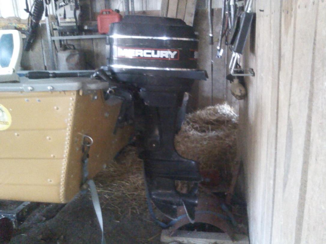

Here is a shot of the 9.9. I guessed it to be roughly a '76 20hp. You can't see it in this picture but it says 9.9 on the rear of the cowling. Will try to get better photos over the weekend.
paul,
That certainly looks like a 20HP. What is the block designation somewhere on the top starboard side of the block up near the flywheel there will be a word like hurricane, panther, tiger, etc...
