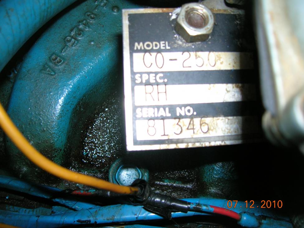

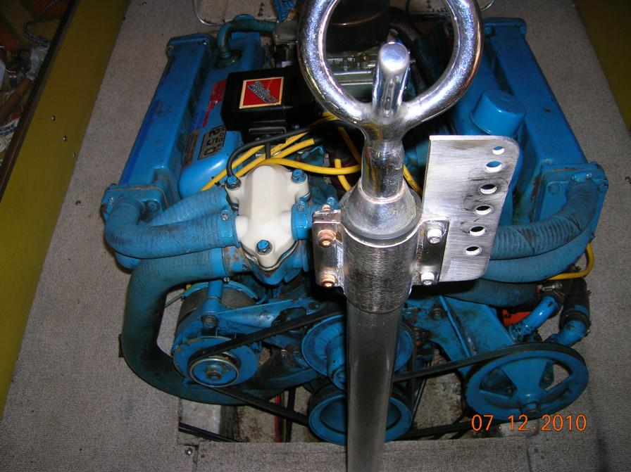

I (supposedly) have a 1972 Correct Craft Ski Nautique SN 1998 with an inboard 351 cu in Ford engine (blue).
Marine Engine Converter: Crusader. Parent Company: Thermo Electron Marine Engines.

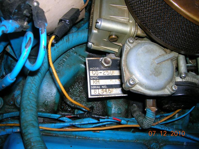

Metal tag on rear right of Holley 4-barrel carburetor says:
Model: CO-250 What does "CO" mean?
Spec. RH What does "RH" refer to right hand of what - propeller,
distributor, or engine (viewed from front or rear)?
Serial No. 81346
I wanted a Crusader Service and Technical Manual 1967-1980 from MarineEngines.com
They said SN 81346 is not listed in their Crusader books!:mad:

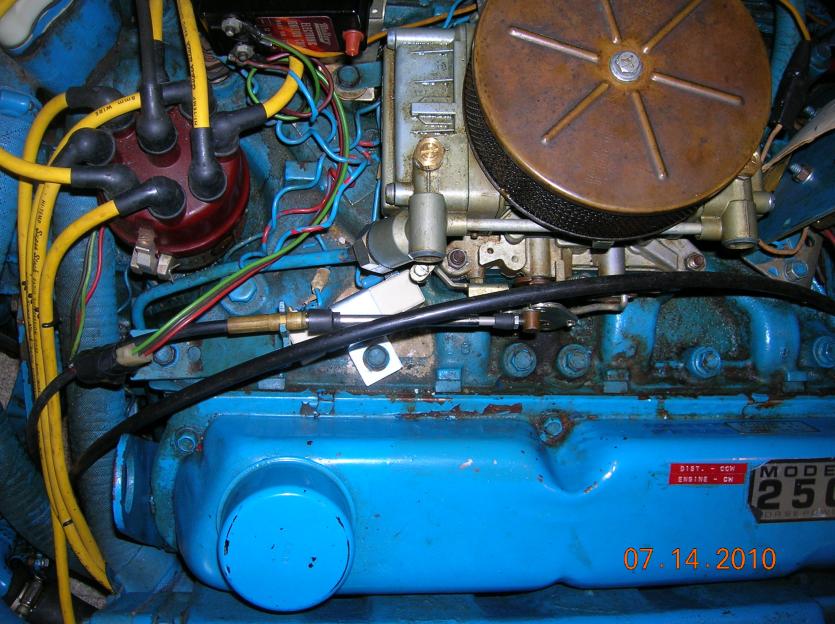

The firing order seems to be different than the firing order for a car.
Can anybody identity what engine I have or offer some suggestions?
I believe what you have is properly termed a Crusader Conqueror engine. From what I've pieced together, the 'plain' crusader label was used on the GM products Thermo-Electron marinized and the Conquorer label went on the Ford blocks.
Sommebody over on the CORRECTCRAFTFAN.com site may be able to give you some more details....I know I saw an archived post a while ago from a guy that had a 1973 ski Nautique and it had a serial number with a comparable value.
So, I'd say you have a 351 Crusader conqueror, rated at 250 HP. RH usually indicates engine rotation - on marine engines, this is ALWAYS determined by viewing the flywheel (RH = CW, LH = CCW rotations).

Two other observations - the resistor isn't readily visible in your pic; maybe you just clicked the wrong one. The other is that flame arrestor is overdue for a cleaning.
