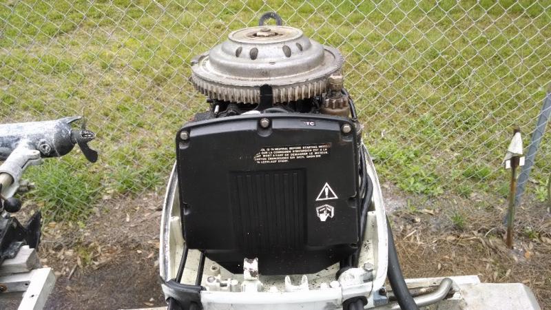

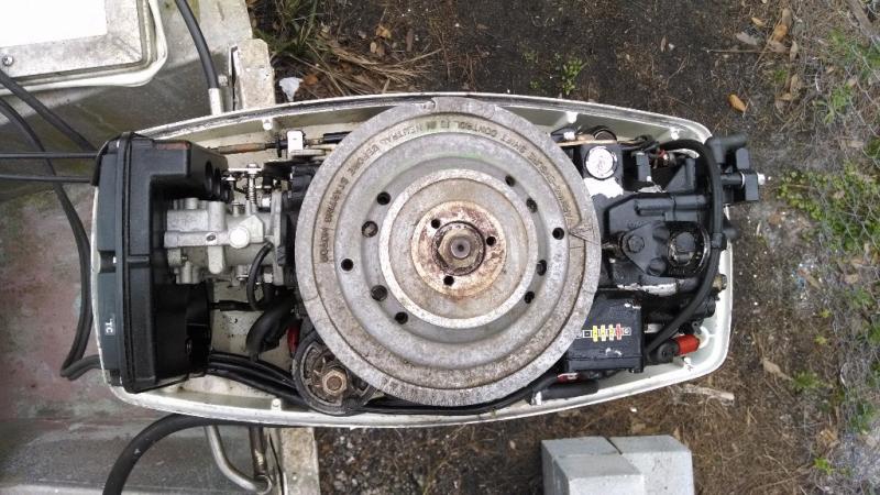

Perhaps you can help me with an awkwardpredicament. Two years ago I bought a used 1985 Johnson 50 hpoutboard motor on Craigs list. 'Paid $700, which I thought was abargain. It works great. Immediately after purchase, I wanted to buyparts to maintain it. But I found both locations for serial numbershad been defaced! Evidently it was a stolen motor. I called the localsheriff, who came to inspect and investigate. After failing to findany additional information during subsequent months, the sheriff'closed the case' and wrote a letter establishing that the motor wasnow legitimately mine. That was re-assuring.
Now, as I try to order parts, thediagrams for a 1985 Johnson 50 hp motor don't match my motor. Forexample, the fuel pump and filter look like those in diagrams of the1985 55hp, but not the 50hp. The cowling was been re-painted. Whatremains legible of the serial number doesn't clearly establish thesize. I don't think it's a 50 hp motor.
I am trying to find someone who is sofamiliar with these motors that they might be able to identify thesize by looking at photos. Attached are photos of the Sheriff'sletter, the defaced ID plates, and photos of the engine. [Limited to 6 photos, I omitted many more, which I can provide if it will be helpful to anyone.] Can you helpme identify the motor? Do you know anyone who can? The motor wasevidently tuned well before I bought it; it still runs fine. I havechanged the impeller, which seemed to fit OK.

Well, the 40 / 48 / 50 / 55 / 60 all look the same since you are not aware of that.----But find the high speed carburetor jet and post the number off it.
The last digits of the model number are still readable CDB. CD makes it a 1986. The B is a bit more challenging. The only 1986's listed here at marineengine with a B suffix are rope start motors, which yours obviously is not. But narrowing it down to 1986 ought to at least help.
Gator..... I thought the same thing about the year.... really looks like "CD"... however in looking closer (enlarging) it appears (to me) that the left side of what I thought was a "D" curves upward on the bottom left and downward on the top left which would make it a "O" (5). I could be wrong but double check it if you will.

The motor can't be a 55HP. The only two 55HP models for 1985 that show up are E55RWLCOS and J55RWLCOS. Those do not match the visible letters on your plug.
As best as I can tell, the last letters on your plug are ELCOB. The two models that closest batch that are J50BELCOB and J50TELCOB. The parts diagram on this site are very accurate. If you put in the correct model# you'll get a list of the OEM parts listed for that exact motor.
My guess is the reason the fuel pumps don't match is because a previous owner removed the VRO pump. This is extremely common on 80's vintage (and later years) OMC outboards. The original VRO design ('84 I think) had some issues that resulted in blown engines. The knee-jerk reaction was to revert back to good 'ol premix and not rely on technology. Some people simply plugged the oil inlet hose of the VRO and just used the fuel side only. Others completely replaced the pump with a single diaphragm pulse pump used on older pre-mix designed engines. That is exactly what I think you have on your engine.
KevinJ, Thanks very much for your input. I have presumed that this is a J50TELCOB. I'll still try to identify the code on the hi-speed jet, hoping that will help confirm the ID. Viewing my carburetor in hand, and the parts diagram, I'm embarrassed to admit that I don't know how to locate the high speed jet (I realize it's obvious to most of you). Here is the link to the diagram: http://www.boats.net/parts/search/BRP/JOHNSON/1985/J50BELCOB/CARBURETOR/parts.html
