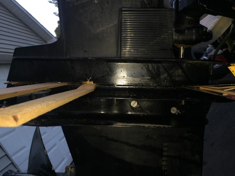

Hello, I have a (new to me) 2001 mercury 90 EPLTO (SN) 0T183215, Model 1090412YN. I need to replace the water pump. I've taken off all 5 lock nuts. Two on each side plus one in the back by the trim tab. They came off easily with no issues. The gear case will not budge though. No movement at all! Not even a little!! I've hit it with a rubber mallet, Used a piece of 2x4 on the cavitation plate and hit that with a hammer. I sprayed liquid wrench all the way around and in the stud holes. I tried to separate it with a sharp wood chisel. I ran the trim all the way up and tried a bottle jack against the transom with some wood pieces as buffers, but nothing. I was thinking of trying some heat. Any other ideas?

No I don't see any others. I did get it to separate about 1/16 - 1/8" last night. I drove a bunch of shims in and sprayed the crap out of it and let it sit till tonight when I get home.

There is not much you can do if the spline of the driveshaft is so to say frozen or rusted in the power head. Do what you are doing. If it has dropped a little bit. Would be best if the motor could be turned upside down. That way you could get penetrating fluid down to the spline. But being a 90hp. You would need something tall to lift it. There are dowel pins on the lower unit that may be the culprit also. If you get it off. Please put marine grade grease on the spline before you get it together.
I finally got it to come off! Gears look fine. It was a build up of sand inside the stud holes that was like concrete! I used a drill to get the sand out.
Nice job, I have an assortment of oak wedges. Don't like to scratch paint either. Take off lots of lower units as I do aluminum welding. Rocks are my good friends.
